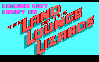

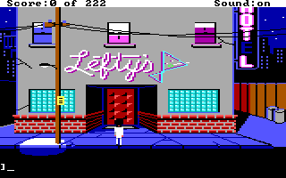

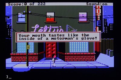

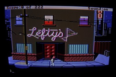

I bought a Compaq Portable 286 saturday and I'm pretty happy with it. I am using an old LCD tv and I'm curious and slightly confused, from my memories CGA is like monochrome or 4 crappy colors, and I'm playing Leisure Suit Larry (one of the floppies I was given with the portable) and it's pretty damn colorful!
Is this a fancy mode I'm not aware of or is that an EGA card that might be in the computer?

Composite CGA ? My dad's old copy of LSL supported that..
https://www.youtube.com/results?search_query=composite+cga
Reply 2 of 15, by VileR
Yep, looks like composite alright.
Many CGA-era games supported extra colors over composite, and Sierra ones are some of the better-known examples. This is known as artifact coloring - a trick, in fact, that leverages the bandwidth limitations of NTSC and turns them into an advantage. Here's a brief description of how it works. Wozniak originally used the same principle in the Apple II, to generate color over composite without including dedicated color circuitry at all.
In normal circumstances, composite on CGA gives you "only" 16 colors. But then, you have this... 😉

Reply 5 of 15, by Jo22
Well, as Vile pointed out, Sierra made better use of Composite CGA. 😀

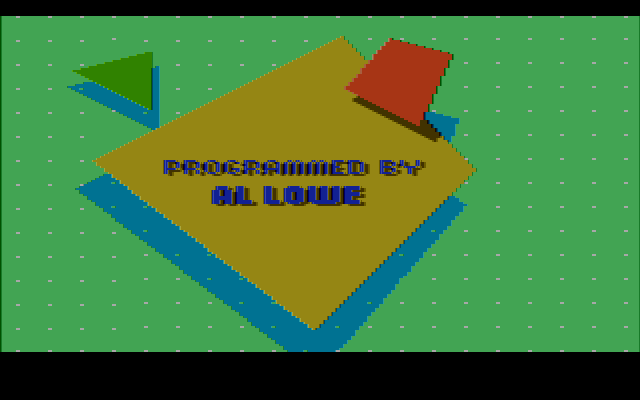

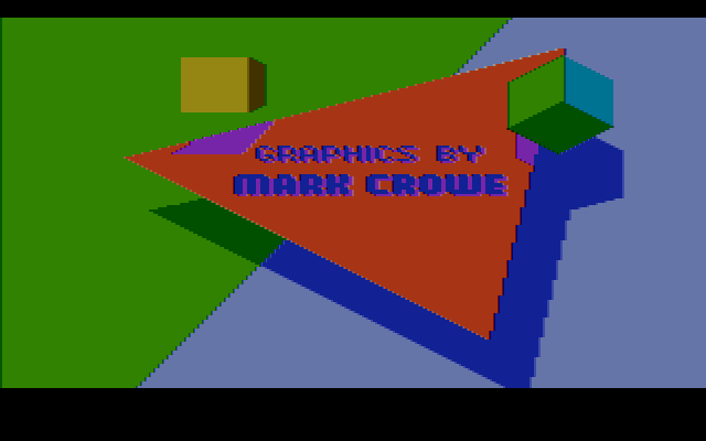

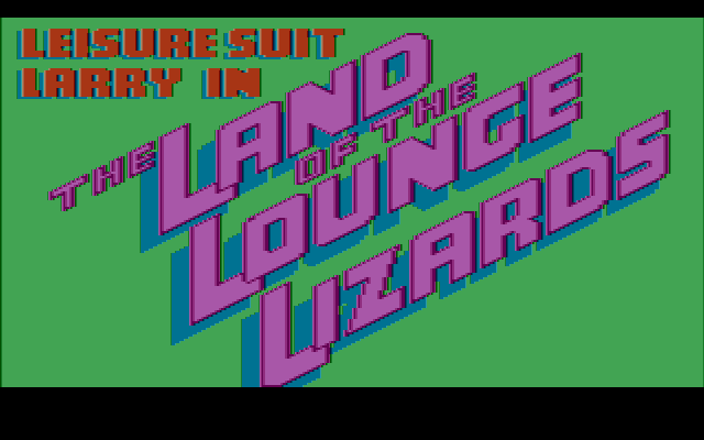

For comparison, I took a few screenshots (in DOSBox) with my father's copy of LSL1..:

Reply 6 of 15, by derSammler
But even they couldn't hide the color interferences. Your last screenshot is a the perfect example for that: even in DOSBox with pixel-perfect output, black-on-white (top row with score) or white-on-black (bottom row with input) is smudgy. On SammyFox' pictures however, it's not - it's almost razor-sharp. So this can't be composite video output.

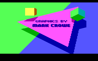

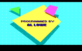

I also took some EGA screenshots with DOSBox. Please notice the vibrant, neon-like colours.
The 3rd screenshot "graphics by" has a green tone that fits less to the OP's screenshot than the Composite screenshot above.
Edit: Also have a look at the window over "lefty's". It's both red in Composite CGA and the OP's screenshot, while it's pink in EGA.

Reply 10 of 15, by SammyFox

Reply 11 of 15, by VileR
Nah. Look at Sammy's last photo - the super-artifacted edges of the "Lefty's" sign, the "O" in "HOTEL", the greenish + reddish color fringes on the black power pole, all are dead giveaways that it's composite. Compare with Joe's last EGA shot; "Lefty's" is white there, and the sidewalk is deep blue. Very unlike the TV photo. The colors in DOSBox's composite CGA shot are a much closer match.
Also, what sort of EGA card can plug into "an old LCD TV" just like that? 😉
BTW, comparing to DOSBox isn't very trustworthy because:
- The composite emulation in 'vanilla' DOSBox is rather inaccurate, even the one in current SVN. The latest composite CGA code (huge thread on top of the Patches board) gives much better results.
- Since we're talking about composite, results will vary quite a bit even on real displays. Internal filtering (especially in LCD TVs) can cause text to appear either less or more smudgy than you'd expect.

Reply 13 of 15, by VileR
Jo22 wrote:
Sadly, I don't have the things required at hand. The CGA card I do have isn't very, uhm, faithful in terms of colours.

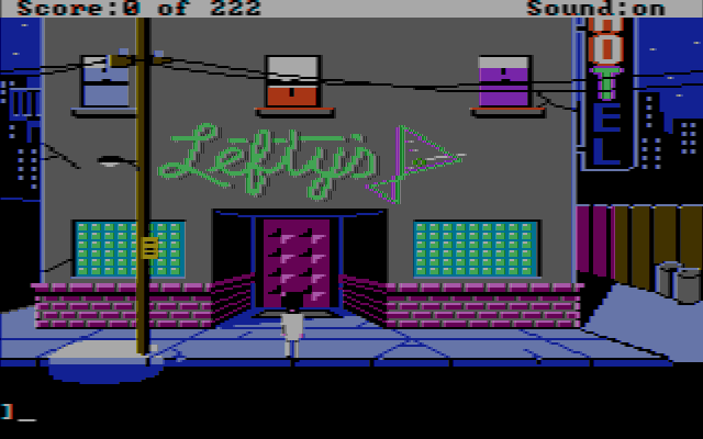

I happen to have those things at hand, so let's settle it then 😀
LSL1 running on a 5160 with an IBM CGA card ("new-style" NTSC output stage), composite signal going to a '99 Brother CRT TV:
495.36 KiB
959 views
Same game / machine / card / cable.... this time on a 2010 Akai LCD TV:
372.64 KiB
959 views
I accidentally a pop-up in this shot 😜 but it just goes to show that a modern TV set's filtering can make the text quite sharp -- even over composite.
In fact, this extra sharpness goes overboard in places. See the noisy serrated edges on the "Lefty's" neon sign, compared to the fairly smooth appearance on the CRT.
I'm not sure why the sign itself is a different color from what you guys are seeing, probably different releases of the game (some of the more discerning Sierra-heads could undoubtedly help out here). But I think we can safely conclude that Sammy's card is CGA too.
