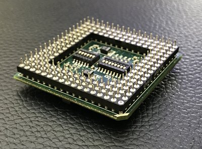

I've got a 5x86 upgrade cpu with a single broken pin. I checked the Socket 2 pin-out, and it's pin D20. I found a photo of the original box contents, and it appears that the PCB sits on a removable plastic PGA platform. I can't put the CPU in my socket 2 board without the platform because the DIP switches will hit the center of the socket. Does anyone have a source for these PGA platforms? It's made by a company called ANDON Electronics. They still exist, but don't sell these in platforms in small quantities.

Thanks for the link. That does appear to be what I'm looking for, but for about that same price($45 US shipped) I can buy a whole replacement 5x86 upgrade chip ($30). I was hoping to find the part for less than the cost of just replacing the CPU.
Reply 4 of 13, by feipoa
Wow, your TrinityWorks PowerStacker has twice as many DIP switches as mine!
You want to look for PGA 168. This one is cheapish. I bought from him before. https://www.ebay.de/itm/ECE-PGA168-SOCKETS-3- … CS/321163112146

Indeed ..you are very lucky it is a corner pin missing ..and imo worth replacing ..
Yoy might even get away with a comonent leg ..say off a resistor or capacitor solderd in and cut to size .
Though it wouldnt be as tigid so it may bend when inserting the chip.
Well worth trying a fix.

Your eBay link is what I was looking for. I did find the US link for that listing, and it's looking like the cheapest option for me. I may try soldering on a new pin as others have suggested, and if that doesn't work, I will replace the riser socket.
gbeirn wrote:
Where are you located? Pretty sure I have an extra one I can send you. Let me check at my office in the next day or so.
Thank you for the kind offer! I'm located in New Jersey, USA.
