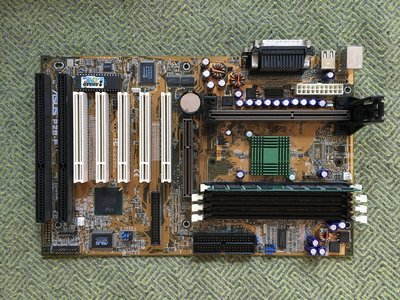

So this has become more than just an issue with a Viper 770. I dont believe its motherboard(ASUS-P2B-F 1.00) ill upload it for you guys to see. All of the traces, caps look great. And i was told it was working. I don't see any issues with the board. And the PSU is new. Now i believe it must be the CPU. I took it out and put it back in, did the same with the ram. Put a new CMOS battery in. Using a 3dfx Voodoo Rush PCI i know works(tested it today in my socket370).
My guess its the CPU itself. I did notice a bit of white coloring on one of the gold contacts, not sure if that's a bad sign. I found myself a cheap P3 Slot1 450, i just have to wait for it to get here. Also can i safely put a PC133 into a PC100 only motherboard? Thanks guys.

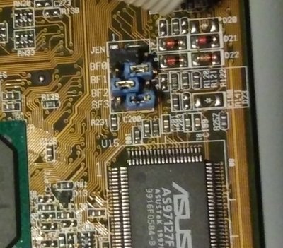

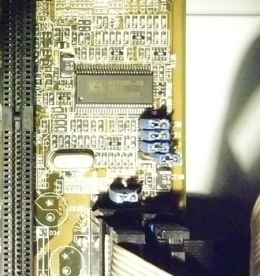

I'm looking at the photo you posted and comparing with the manual. It looks it's set to 75MHz FSB with a 6x multiplier and AGP running at 2/3 of FSB. If this is how the board is actually set right now then it's unusual.
The 75MHz FSB is probably overclocking the PCI bus, although not severely. PCI is used for southbridge communication among other things so it won't run if PCI isn't stable.
Try setting the FSB to 66MHz. Also make sure the multiplier is jumpered correctly. Most slot-1 CPUs are multiplier locked but if the setting doesn't match what it's locked to, maybe it can refuse to boot (I don't remember).
Keep everything very conservative until you can get it to POST.

Okay i will try all those things for sure. The jumpers though btw were set like that when i got it. I changed it to match the 450 Mhz Pentium II SECC2 i have. I could besure again that my jumpers are correct. Ill get back to you again soon. And thank you again.

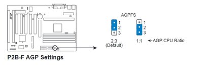

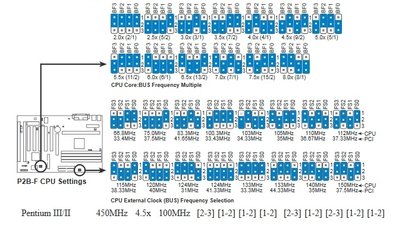

I think i have these set right. Unless someone thinks otherwise. Again this is a Pentium II 450 Mhz.

Your image shows correct jumper settings to my eye.

I agree, the jumpers look correct. Still, I'd try it set to 66FSB just to make it as easy as possible for the board to be able to boot (just in case it's a stability problem). If you do that, I think you can just leave the AGP jumper where it is, although technically you're supposed to move it to the 1/1 setting (at 100FSB it's set to 2/3).

Ill try setting the jumpers to 66FSB and see where that gets me. Thanks again.
EDIT. YOU WERE RIGHT. I set the Jumpers to 66FSB. I got it to Boot! We are getting somewhere.
