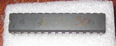

Most CCChinese srams are shit, plain and simple. BUT, if you're patient you can start selecting the good ones... out of a gazillion dung beetles. There are, of course, exceptions - some users have reported very good results with them BUT the problem is you never know from which batch yours came.
I have bought over 200("farewell money") and the quality went down quite a bit.
You're way better served buying original ones and speed selecting them, albeit the 512ers may be even more sparse then the 256ers.
Also consider that even among officially produced chips there may be a huge fluctuation of component quality.
Attached is a picture of an Alliance-labeled chip that made it through 50mhz as a tag. It was the only one out of the bunch.

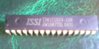

Yes, they have 8076ACVD and JV530111L and TAIWAN. Sorry for the quality of the photo, my mobile phone is not good.

I have tried to select the four best with Memtest. You have 126 possible combinations of 4 out of 9 chips if you do not care about the order (though I think the order also affect performance), too many to test them all. I have tried to find a relation between the errors thrown by Memtest and the chip that originated them with no success.

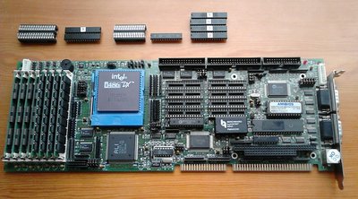

I have another working PC with this ASC486 board:
513.18 KiB
1662 views
I could use it to try the double banked way but I lack the 64Kx4 sram required for tag.
Size Bank 0 Bank 1 TAG
32KB (4) 8K x 8 NONE (1) 16K x 4
64KB (4) 8K x 8 (4) 8K x 8 (1) 16K x 4
128KB (4) 32K x 8 NONE (1) 32K x 8
256KB (4) 32K x 8 (4) 32K x 8 (1) 32K x 8
512KB (4) 128K x 8 NONE (1) 64K x 4
1MB (4) 128K x 8 (4) 128K x 8 (1) 64K x 4
