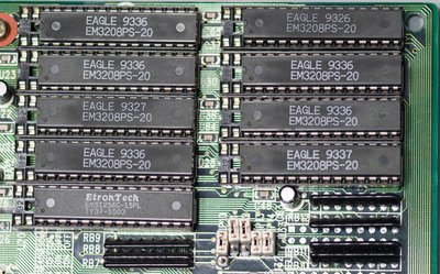

I am working on getting my 486 build working.
The motherboard is a PC-Chips M912 v1.4.
CPU is an Intel Overdrive DX4-75.
If I have the external cache enabled in the BIOS, it will not get past the initial boot screen after detecting the hard drive.
The cache jumpers are set to what they were when I got the board which is also the setting shown in the picture included with the only instructions I could find for the board.
Does this sound like bad cache or maybe the jumpers are set wrong? I was unable to find any information on how to set the cache jumpers for different cache amounts, so no idea what it is actually set to.

Here is a pic of the cache. Not even sure if the chips are real. Supposedly they are supposed to be, but who knows. I am unable to find any information on the Eagle chips.

Messing around with it a bit more and got it to go past the initial POST screen but then locks at the system info screen.
I removed and reinstalled all the SRAM chips and the tag chip and reinstalled them. I figured maybe it was a bad connection.
Now it will get to the info screen every once in a while and says that it has/is set for 128KB cache.
It still won't go past the info screen with the L2 cache enabled in the BIOS.
I also tried a couple different sets of RAM just in case. Could it be something with EDO compatibilty? Going to try some FPM and see if that changes anything.

Reply 6 of 13, by derSammler
According to this:
http://www.elhvb.com/mobokive/Archive/Oldman. … hips/memory.htm
you can not have 128 kb cache with both banks filled. The installed tag ram and the jumpers suggest that the board was running with 256kb L2 cache. Probably the previous owner took the SRAM chips out and installed some other chips he had no use for...
Reply 7 of 13, by cyclone3d
Ok, so getting somewhere.
I had actually installed the cache jumpers incorrectly for 128KB instead of 256KB when I was messing around with it trying to get it to work.
I can now get it to boot with it set to 128KB, but not set to 256KB.
I am guessing that the SRAM is just really crappy or faulty and I need to get some new SRAM chips.
With the current SRAM, it will work like this:
25Mhz FSB (auto RAM settings in BIOS) with FPM 72-pin RAM.
33Mhz FSB (manual RAM settings in BIOS) with FPM or EDO 72-pin RAM.
I haven't tried messing with a longer delays for the RAM or cache in BIOS to see if I can get it to work set to 256KB.
Thanks for that link, that is very helpful.

Reply 8 of 13, by cyclone3d
Well, I have 2x 256K dual bank sets and 2x 256K single bank sets (so I can make a 512K set) on the way. All are 15ns instead of the 20ns that I currently have in all boards.
If all of that works, it should give me enough SRAM to put 512k in this board and 256k in the other 2 boards I have.

Reply 12 of 13, by cyclone3d
The 2x 256k double bank sets I ordered came and I replaced the stuff that came with the board with one of the sets and it now boots properly with it set to 256k and it also works with the bus speed set to 40Mhz as well with 2 VLB cards installed. I hadn't tried 40Mhz before but I really doubt it would have worked with the flaky 20ns cache chips.
