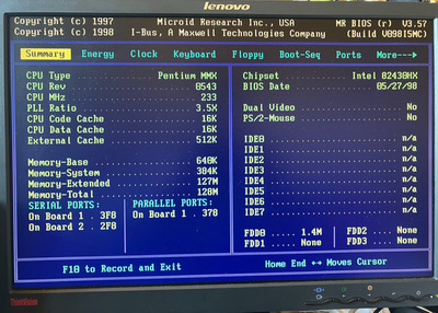

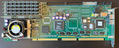

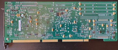

Reply 374 of 385, by Yrouel
Got this I-Bus SBC today:
Intel 82430HX
MR BIOS V3.57
Build: V098I5MC
Date: 05/27/98
EDIT: I re-dumped the BIOS using both Microid Research own MRFLASH utility and a TL866 (these two matched), I deleted the previous incorrect dump (only half of the content it seems and I'm attaching the new one
Reply 375 of 385, by jheronimus
Yrouel wrote on 2024-01-30, 14:45:
Got this I-Bus SBC today: […]
Intel 82430HX
MR BIOS V3.57
Build: V098I5MC
Date: 05/27/98
This is very interesting. Not only is this a new Soc7 image, but it's also the first I see a MR BIOS firmware newer than 3.46.

Reply 377 of 385, by Yrouel
jheronimus wrote on 2024-01-30, 14:47:
This seems to be the board by the way https://theretroweb.com/motherboards/s/i-bus-ibus-mako
Reply 378 of 385, by Yrouel
Intel 82430HX
MR BIOS V3.57
Build: V098I5MC
Date: 05/27/98
To whom is curating the archive, please replace the previous binary file with this new one which is a proper dump, sorry for the inconvenience
    V098I5MC_mrflash.ROM.zip
    68.07 KiB
    17 downloads
