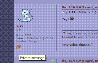

Reply 47 of 66, by Jo22
Parts man wrote:
I tried PM a user the other day. I could not find the option for it.
I don't think this site has a PM system. That or I'm Mr magoo and can't find it.
Hi, Vogons has a PM system. Not sure how many postings are currently required for someone to have before it becomes accessible.
Here's the icon that you usually can click to get into the PM editor. 😀
    8.68 KiB
    1188 views
Reply 48 of 66, by MrSmiley381
I actually was able to do a PM from the user control panel.
That being said, that "message" icon very clearly screams "profile". It's a silhouette of a person's head. A PM icon should be something like a text bubble!
I spend my days fighting with clunky software so I can afford to spend my evenings fighting with clunky hardware.

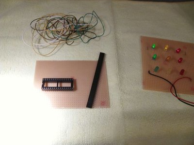

Reply 50 of 66, by Jo22
Little update. I decided to build a little shield for the RAM chip, to make sure I will not mess up the wiring on the ISA card.
Maybe I can get a few parts on Friday or so. I'll post some pictures once I've got things together. 😀
Edit: Got them. 😀
    274.58 KiB
    1123 views

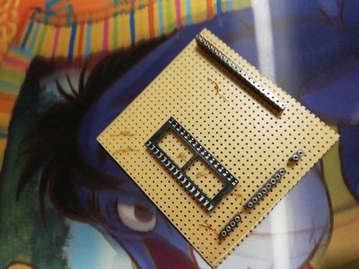

Reply 51 of 66, by Jo22
Update.
Hi everyone! Just worked a bit on the daughter card so far.
- It's not finished yet (-I lost that pin bar-), though.
Anyway, I've attached some pictures for you! ^^

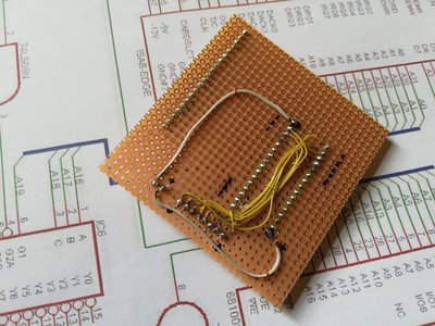

Reply 52 of 66, by Jo22
Update. A little bit of progress again. Next station - wiring.

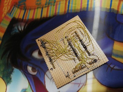

Reply 53 of 66, by Jo22
Update. Attached the wires for data.
    790.56 KiB
    1081 views

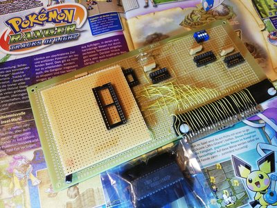

Reply 56 of 66, by Jo22
Update. Good news, I finished the wiring part (I think so). 😀
    809.69 KiB
    1045 views
