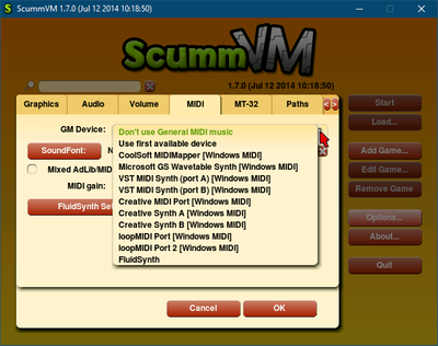

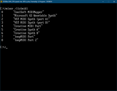

I feel you overestimate the problem. What is so extremely specialized about that required Midi In and Midi Out ports have to be explicitly selected? Explicit port selection in Midi software itself was the right way even from the beginning. But some Midi software decided that they omitted explicit port selection and always used the default one. These software has problems since Midi mapper has gone. But other software that allows users to select ports explicitly can work that same way in Win10 as in Win7/XP/Win9x. DosBox and ScummVM belong to the 2nd camp. They allow you to select your desired Midi ports explicitly and this works the same way on Win 8/10/11 as on Win7/XP/Win9x.
In DosBox you can use mixer /listmidi to get all the possible Midi out ports and then you can set the desired port number in dosbox.conf. And in ScummVM you can still select your desired Midi ports from the UI.
You do not need any Midi mappers for such direct port selections to work.
While for me personally it's quite annoying having to manually select it every time, there's a much bigger problem: not everyone knows about this stuff. Most people don't even know what MIDI is. If I want to help someone get setup with DOSBox I wouldn't even begin to try to get them setup with anything but the built-in MIDI options because, let's be realistic, their eyes are just going to glaze over and they may even stop right there. It also makes it impossible to produce a single ready-to-use setup that uses any MIDI device that isn't built in because you simply don't know the result on any other system (in fact, it's distinctly possible it simply won't work consistently even across your own systems that you do know.) Even if I walked someone through the process of installing the VSTi driver and all the files necessary, I then have to walk them through the selection process as well and try to explain to them that it can change and they may have to redo things (remember the issue of the disappearing VSTi driver.)
But also, I think you missed something else entirely in what I was saying: I'm saying also that the current system WILL break. Even assuming that MS never eventually stops us from installing external MIDI options (which I point out is still a realistic possibility) what I mean is the actual software eventually will break as we move on to systems that lose legacy compatibility and can't be used at all on anything else but what they were intended for. For example, the S-YXG50 VSTi is a 32-bit x86 binary. It will not run on any ARM system unless you setup some sort of very complicated CPU emulation process for it (which I just don't see being a thing people would even do for MIDI.) Eventually we may end up in a scenario where even modern x86-type systems can't run 32-bit executables. Besides the obvious (someday far far down the road I presume we'd eventually move to 128-bit addressing, so then we'll lose 32-bit once we do) there is probably a more likely scenario that major changes might perhaps make 32-bit support even on 64-bit systems become undesirable such as processor extensions that break while 32-bit access is allowed or something of that sort of nature. While nothing specific of that sort is on the immediate horizon, it's distinctly possible. Just look at the way Intel was willing to let their Raptor Lake processors basically break in anything below Windows 11 or anything but the very latest Linux kernels. (Since the economy cores don't have the same extensions as the performance cores, the kernel must intelligently route commands to the correct cores. Sending higher extension commands to the economy cores causes things to crash and burn when they fail.) It seems that they're in a benchmark war (my Ryzen 5600X -- which is a "low heat" 65W TDP processor -- could hit 80C almost instantly under heavy loads such as encoding with the stock HSF and settings. And when I say almost instantly I mean LESS than one second and would go over 90C within mere minutes then start downclocking.) Not only is it realistic that compatibility with things people don't normally even think about could be lost -- such as MIDI -- but with the way things are going it could even happen in the near future. Right now it's impossible to really predict, but you must admit that MIDI is pretty darned low in the list of legacy compatibility considerations.
No I'm not saying all support for MIDI as a whole will go away, but, if we want to continue using it the way we have been -- such as for playing retro games with the sound the right balance of "as intended" and still being as good as it reasonably can be given the limitations of the mechanisms themselves -- we need to at least be thinking in terms of what might be done in such a future. And to be clear, I'm not saying "WE MUST FIX THIS NOW!!!ONEONEONE" I'm saying "loss of compatibility is on the future horizon, we should prepare in advance instead of waiting until after it happens."
