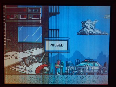

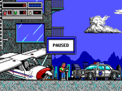

I have laptops with these awful passive matrix displays and they're just terrible for any game with moving graphics. Even stuff like Cosmo's Cosmic Adventure (which runs at 9 fps) is pretty much unplayable on these displays. If you thought the early TFTs were blurry, these are beyond blurry. And the image quality seems to get worse over time, just look at this:

BioMenace on a bad passive matrix display.

BioMenace in DOSBox.
See those vertical bars? This seems to be a common problem with old passive matrix displays.
If you're going to buy a laptop with a passive matrix display, try it before you buy it. Let it display something with high contrast for a while and see if the image gets worse after a couple of minutes. Run a game on it and see if you can/want to live with the blur.
