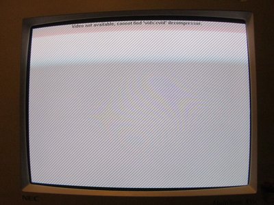

FMV:
Recently, I've been having quite a hard time getting certain FMVs (AVIs) to play under Windows 95. This seems to have occurred after installing Aladdin Activity Center. I know part of the reason is because my system.ini is missing the line VIDC.CVID=iccvid.drv under [drivers], but for whatever stupid reason the line is automatically deleted after every reboot and I have no idea what to do. I've removed every trace of the game, and it still does this. Does anyone possibly know a solution?
Me trying to play Boggle CD-ROM:
884.4 KiB

Reply 1 of 3, by Jo22
thepirategamerboy12 wrote:
FMV: Recently, I've been having quite a hard time getting certain FMVs (AVIs) to play under Windows 95. This seems to have occu […]
FMV:
I'm not certain. You could try to rename that driver file, say to iccvid2.*. Not sure if that helps, though.
Maybe someething is trying to delete everything that's "VIDC.CVID=".

Reply 3 of 3, by thepirategamerboy12
Very mind boggling, indeed. Anyways, just now have I been able to get back to this and try some of the suggestions. I renamed the file, and this worked temporarily. When I go to reinstall Boggle, however, it does the line deleting again upon every boot up... I did notice a blank entry of [iccvid.drv], so I removed that and once again, it stopped auto-deleting the line temporarily, but when I go back to install Boggle or another game using that file, the line is auto deleted again...
