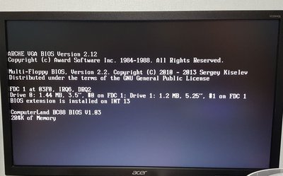

I have the same arche technologies VGA-0021A card but different BIOS.
It shows "ARCHE VGA BIOS Version 2.12" as shown in the photo attached, not "EAGLE II VGA BIOS Ver 3.00".
So, what's the difference?
