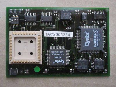

Evergreen "Rev To 486" part 295. The 50Mhz version is part 294. You can also consider "Make it 486" from Improve It Technologies, and I think Kingston also had a few kits. You can also try Yahoo Japan. There are some upgrades designed for PC98 systems, but I have two from Buffalo and they work just fine in my AT. Most of these kits are a kind of a pain in the ass to get fully working anyway.
Reply 26 of 28, by TimWolf
Thank you very much. Do you think this will work?
Reply 27 of 28, by Anonymous Coward
I think there is a reasonable chance it will. Looks like an IODATA. Try to find out what the DIP switches do.
