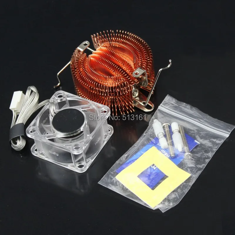

Otherwise, I will have to make do with one of two choices; one is a simple hefty heatsink like the one below. However, I can not be sure that the flat bottom will cause issues due to other SMDs on the board, and would be glad if anyone can confirm this. If anyone could tell me the H/W/L of the stock aluminum cooler on the card that would also be great as I am considering trying to find a replacement that resembles the original cooler in size and weight.
182x100x45mm-Aluminum-Heat-Sink-Radiator-Heatsink-For-IC-Electronic-Chipset-Heat-Dissipation-High-Power-LED-Amplifier.jpg_200x200.jpg
Failing this, I will have to revert to chipset coolers, but stick one on with adhesive tape. For that I am again considering these 40mm chipset coolers.
1PCS-Aluminium-Heatsink-Fin-Cooler-40mm-Fan-For-PC-Northbridge-Chipset-3D-Printer-Cooling.jpg_200x200.jpg 10-pcs-Gdstime-Northbridge-Cooling-Fan-Southbridge-Chipset-Heatsink-with-40mm-Fan-12V-3-Pin-4010.jpg_200x200.jpg
So if you could answer some of the questions I had about physical dimensions of the card, or point me towards what you think is the best choice, I would greatly appreciate it.

The only one that I am now confident will be enough is this:
The pin spacing is adjustable between 50-62mms so it looks like it would be perfect:
Aside from possibly blocking a one or two PCI slots.
Alternatively there is this chipset cooler that has semi-adjustable spacing, which covers 50mm to 80mm spreads.
There is shorter version without pin legs that I could apply with thermal adhesive tape, though I don't know if these would be adequate for cooling a Voodoo 3?
Another interesting option I came across is this Pentium M cooler which APPARENTLY has 58cm diagonal spacing.. Maybe I should be looking into Pentium M coolers for this job?
Finally, there is this aluminum heatsink block I could buy.. The original heatsink is 75x45x10mm according to a friend's measurements, so if I were to saw 25mm off from one end, then drill the peg holesi I suppose I could, theoretically, fix this onto the card, though with what, I do not know. There is also the question of whether any components on the board are taller than the CPu and would mess this up..

Thanks for all the info, ended up ordering this:
The fan on the heatsink is rather thick and could potentially block a second PCI slot I guess, so I will replace it with a much slimmer 40mm fan I have lying about. This ought to do the trick just fine, I think..
