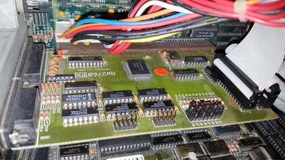

I received the pc today and the case seems be in decent condition and I just opened the case. I think I got it at decent price even if motherboard ends up being useless. There is an old Tseng ET3000AX VGA card which is probably very slow, Goldstar I/O card, 5 1/4" floppy driver (which I only had 1 before this), 3.5" floppy drive, AT psu, Mylex MAE486 motherboard and 486 33Mhz cpu.

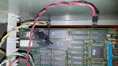

There is a dallas battery, but something seems to be connected to it. Should I leave it as is or should I still try to find replacement for the dallas chip?

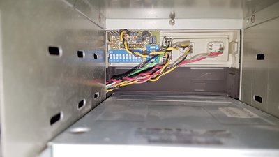

Anyone know anything about configuring the mhz display at the front of the case? As you can see in the picture, there is alot of switches.

You could be in luck with the Dallas battery, looks like the mod to hook up a coin cell battery to replace the internal battery. If the Dallas battery is soldered to the motherboard, this is pretty handy.

Brickpad, the guy with the same machine, might be able to help you set the MHz display, but I've also got a display with DIP switches (different layout though) which seems to be uncommon. The one in my desktop uses segment combos to create numbers, instead of mapping each switch to an individual segment. It took some trial and error to get it working. Hope yours is easier to configure. Nice system, by the way!

Would anyone happen to know where to find jumper settings for the I/O card that came with the PC? It happens to have a joystick port at the back, so I think I would have to disable it to be able to try installing any sound card to the system.

Reply 5 of 66, by PCBONEZ
There were many versions of that. The contents of the box with "PX" on yours changes between them.
I do not know if the different versions have different jumper settings.
This one states the PX so it's yours.
