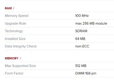

I have a Compaq Presario 7476, which came with 06ECh (very informative name) motherboard. I know it has a VIA MVP4 chipset and an AMD K6-II 533 Mhz processor. Does anyone know where I can find the manual or complete technical specifications? I'm facing problems to install RAM modules.
Compaq 7476 - AMD K6-2 533 Mhz, 192MB RAM, 3dfx Voodoo 3 3000, Windows 98SE

The RAM is nothing special. Plain Standard PC100. - What is the problem?

I've tried PC100 modules with different capacities (128/256 MB), but without success. The system boots just with the original 64 MB RAM module. Apparently, there is no special requeriment. So, maybe it's some kind of incompatibility related to the brand. Do you know which are the most compatible brands of RAM?

I don't remember VIA MVP4 being that picky about RAM.
As long as it's a major brand and the correct kind it should be compatible.
Are you certain they are plain non-ECC non-registerd modules?
Do the modules have an even number of chips or odd?
Can you post photos of give the numbers off the module and chips?

@Espreitador, will it boot with only the 64MB DIMM in any of the 3 slots, or just the first? As suggested, post pics of the DIMMs including the 64MB one showing as much detail as possible (just quote the numbers if you can't get clear pics)

The motherboard you are looking for is Mitac 5114vu.
None of the manuals mention RAM compatibility, though.

Iirc the MVP4 required that the first DIMM slot be populated for its IGP. Did you test the other DIMMs in the same slot as the original 64MB? If not, try that first.
As for compatibility, ignore the DIMM brand, it's almost all about the chips. Look which chips are on the 64MB DIMM that do work. In case of doubt, try to find other DIMMs with the same chips, or failing that with the same brand chips. But issues there would surprise me - the MVP4 swallows almost every kind of chip out there (even the nasty x4 single sided 16 chip ones), worst case if the chip densities are too high it would only be able to use half the capacitiy - but it should boot regardless.

Thank you for replying. I didn't know the motherboard name was Mitac5114vu. I found a PC133 128MB module yesterday. I installed it in the first slot and it worked flawlessly. After that, I installed the original module in the second slot and the system recognized 192MB (yes, mixing PC100 and PC133). Maybe the others modules were damaged. I've bought them recently and they should work, but...

Likely you have a board that supports memory modules with only lower density chips. I remember this from when people started shifting from early Pentium II/III to later III/early P4. You could buy the same amount of RAM on a module that had chips on both sides or one side only. The one-sided modules had higher density RAM chips, which some older spec boards didn't support and thus you'd end up with half the RAM or some other weird issues. The higher density chips were naturally needed for boards that supported more memory in the limited memory slots they had.
