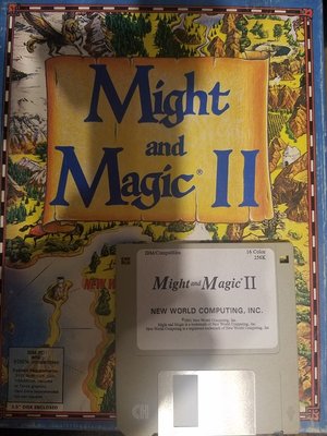

Does anyone have a physical disks for this game in the 3.5" format? I'm curious if the file lists match up, and how many disks it is on. Mobygames shows the 5.25" screenshot as disk 1/3 but they do not show any distinction for the single 3.5" screenshot. I know, however, that all of the files that are installed from the GOG version cannot fit on a single 720KB disk -- even with the GOG specific files stripped out.

Here is my 1.44 3.5" floppy:
Volume in drive A is MM2_IBM
Volume Serial Number is 11FE-1719
Directory of A:\
07/11/1989 01:21 PM 3,504 1MENU1.OVL

It's the real thing. You're right it wouldn't fit on a 720k 3.5".
213.75 KiB
2283 views
You can tell from the 1991 copyright on the disk I have a later release.
Reply 13 of 19, by infiniteclouds
Hmm...
GOG version has .... Monsters.16 (168,257 bytes) compared to your Monsters.16 (217,715 bytes) -- that is a pretty sizeable difference.
Also Timer.DRV is 759 instead of your 764.
Reply 14 of 19, by infiniteclouds
I managed to find images of an older version than the one I bought on GOG and through using the .4 and .16 files from GOG and the .OVLs/.EXE of the older version I am able to get the game to launch and play -- however this older version requires a "Player Disk" to save so it is still unplayable in that respect.
It seems as though there is something about the 3.5" release that makes it unplayable on this XT configuration?
