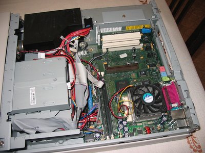

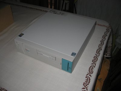

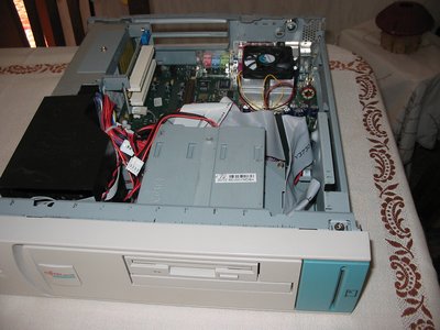

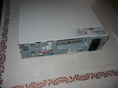

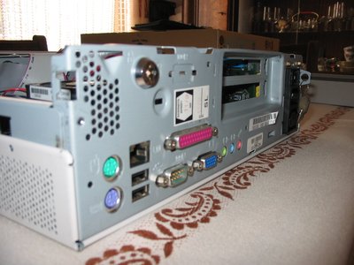

Reply 25 of 36, by dr.zeissler
FSC Scenic XS
MOB: D1215
CPU: 1400 Tualatin P3
RAM: 512 MB
FDD: 3,5" 1,44MB
CDD: DVD-Rom Slim
HDD: 40GB IDE
PCI1: ESS-Solo1 PCI
PCI2: R7000-PCI 64MB
HDD: (XFDISK Bootmanager)
02GB P MSDOS62
02GB L DOSDATA1
02GB L DOSDATA2
02GB L DOSDATA3
26GB P WIN98SE
06GB P WIN2000

Reply 26 of 36, by dr.zeissler
I have lot's of options with this machine:
- CPU 533-1400 Mhz
- OS/2 NT4 WINXP also possible
- PCI GFX R7000/R9000/GF6200/MATROX MGA/MIL/etc.
Retro-Gamer 😀PowerMac 6100-66/Houdini 486/66 - G4 Cube 450/Rage128pro OS9.0.1 - Macintosh LC/Apple IIe Card OS6.0.8 - Acorn A4000 Archimedes - Unisys CWD 486/66 + Aztech Washington
Reply 27 of 36, by weldum
First of all, really nice machine, second, i think it's fine the computer.
You should try some video card in the lines of the Matrox g400, the voodoo 3 3500 or a TNT 2 Ultra, to see if there is any difference in performance or compatibility.
Still, for that processor, i would use something more powerful, a radeon 8500 or 9700 pro, or a geforce 4 or 3 if available
The gf6200 is not very recommended because of only one driver for 9x, and lack of support for palletized textures and other things
Ohh, the humanity 😢
386SX 25-C3 800-P3 900-Atom 1.6-C-D 2.13-P4 2.26-P4HT 3.0-P-DC 1.6-AFX 2.6-FX 3.3
Reply 28 of 36, by dr.zeissler
The AGP Slot is not usable because of the casedesign. I 'll have to stick to PCI-Cards, BUT I can chose from a lot of different ones 3D Accelerated Games List (Proprietary APIs - No 3DFX/Direct3D)
Some I do have https://www.flickr.com/photos/94839221@N05/al … 157695724554005 , some I don't have at the moment.
G400 is none PCI, V3-2000 works; I don't have any TNT PCI Card at the moment. R8500/9700 GF4/3 are AGP, GF2/4 MX as PCI could be possible.

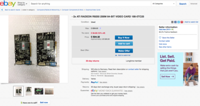

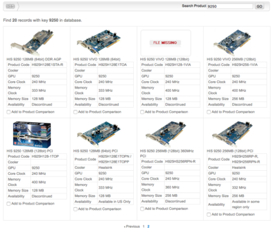

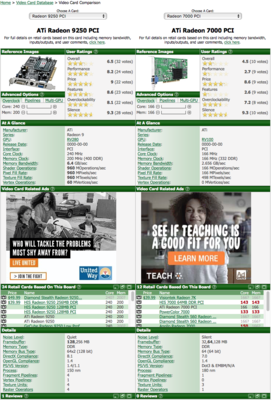

Reply 31 of 36, by dr.zeissler

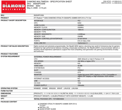

Seems to be difficult to find a real 128Bit R9250 as an upgrade-option to the R7000. Don't know why this is so confusing. I good indicator should be if the vram-chips are above and right beside the gfx-chip. that might indicate that the card has a 128Bit memory interface, but some pictures form the manufactures seem not prove that 100%.
I think I should go for a 256MB card. that's perhaps the best chance of getting a 128Bit memory interface, or what would you suggest?
