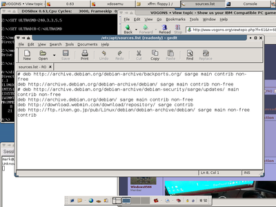

Reply 45 of 81, by Caluser2000
dionb wrote:
feipoa wrote:
Have you tested the CPU load and throughput of a gigabit PCI card on these slower systems?
Tbh I consider ISA to be more interesting, but getting those to work under ancient Linux will be a challenge - there's no repositories for software from 15 years ago online,
You obviously are not looking hard enough then. I used a few Debian Sarge repository's just this morning.
