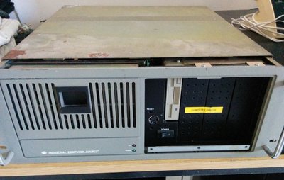

PC itself isn't that great and isn't in the best of condition. Here's a shot of the front panel and some of the rust on the lid. The yellow label says "computer switch" and it looks like it's meant to be behind a panel that folds down, but it's missing. The panel on the right just holds a dust filter for the fans that sit there. Only unusual thing is above the keyboard port there are another two DIN plugs for two more keyboards to be connected, but those are obscured behind the metal panel. I guess this was an option so you could fit three SBC boards in a single case, with a suitable backplane.

Front panel

Rackmount At case nice!
I keep throwing around the idea of racking my old PC's (I have enough of them) but I know I never will really.
ATX era would be fairly easy, AT's would be almost impossible to do without compromises.
The fact it is rack mount pretty much confirms it probably sat mounted with the phone system/DJ system or whatever it was hooked up to and probably did nothing else but that job.
