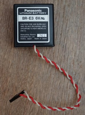

Some of you may know I picked up an old NEC Powermate Portable APC IV system. The CMOS battery is definitely not holding charge. It is a Panasonic BR-E3:
87.42 KiB
938 views
I found only two resellers that might have one. One in Miami, but they may not carry them anymore and one in the UK. There is an Ebay seller that has them, but they don't ship to the U.S.
https://www.ebay.ie/itm/PANASONIC-BR-E3-LITHI … =item4d56533f5b
It's a 6V battery. Any ideas of what I could use if I come up dry? It has a 4-pin head.

The original battery is non rechargeable so there should be no back feeding current. You can check for a forward diode drop between positive and negative on the battery header with high impedance in reverse.

You could use a combination of two CR123A or a CR P2P instead, because thats basically whats inside this box. The connecting wire of your battery pack usually holds a small resistor to limit current draw. You should use this for your selfbuild replacement

The distributor tech support was telling me that this battery is 1.2V higher, but may work just fine. Couldn't that fry something on the motherboard of my NEC Powermate Portable though? Would 1.2V higher be an issue than the factory standard 6V battery?
