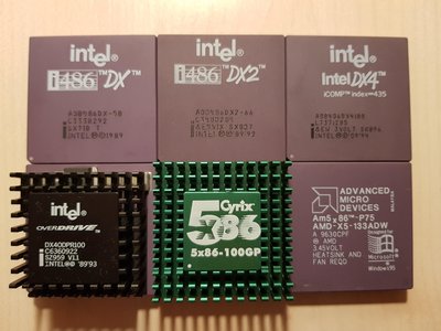

Reply 43 of 52, by arncht
dx2-66 added
CPU ranking (default settings):
40,77% Intel 486DX 33
57,84% Intel 486DX 50
71,78% Intel 486DX 66
99,40% Intel OverDrive DX4 100
99,54% Intel DX4 100
100,00% Intel DX4 100 WB
103,23% Cyrix 5x86 100
108,07% Cyrix 5x86 120
112,70% AMD 5x86 133
CPU ranking (fastest settings, overclock):
130,37% Cyrix 5x86 120
144,36% AMD 5x86 133 @ 160/40
CPU MHz scaling (performance / internal clock):
84,74% AMD 5x86 133
90,06% Cyrix 5x86 120
108,76% Intel 486DX 66
115,68% Intel 486DX 50
123,55% Intel 486DX 33
