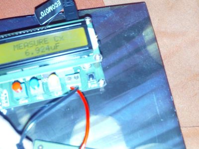

The measurements are as following:
C59... 7,605 µF
C61... 7,470 µF
C62... 7,407 µF
C63... 7,341 µF
C64... 7,450 µF
R14... 4,63 kilo ohms
But please keep in mind that these are just estimated values.
- My LC meter can't properly measure them if they are soldered in.
Edit: R14 is labeled "472".
Edit: Note that some of the caps were in parallel, when I measured them..
Reply 9 of 17, by gdjacobs
You're measuring in circuit (therefore in parallel), so you can summarize as follows:
Capacitance values as indicated represent the max possible values for the component under test (as Ctest = Cmeas - Cext).
Resistance values as indicated represent the minimum possible values for the component under test (as Rtest=RmeasRext/[Rext-Rmeas]).
Reply 10 of 17, by Jo22
gdjacobs wrote:
You're measuring in circuit (therefore in parallel) [..]
Yup. - Also thanks for the explanation. 😀
Can we assume that the caps could *roughly* have a capacity of 4,7µF each (closest standard value),
if two of them in parallel have ~7 to 8 uF´ ?
(That's what the LC meter says. It sometimes jumps to PF values, too.)
I'd really love to take them out of the PCB for correct measuring (hand capacity is an issue, too),
but my hands aren't restful enough for that. 😅
If I try, I sure wouldn't be able to put them in again. 😵

Reply 11 of 17, by gdjacobs
You can't really make any further conclusions without a some idea of what's visible in circuit from that particular test point. You don't need to remove the component - lifting from one of the pads would be sufficient.
When they're not glued down and I don't have any chip quik, I wick up as much solder as I can on one side, then I gently lift that side of the component while applying heat alternately to both pads. By melting the solder on the other side of the component, you'll release any tension on the pad as the component rotates up.

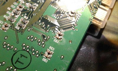

Reply 13 of 17, by Jo22
You're welcome!
I hope you can get your card fixed - Good luck! 😀
Thanks for this tip, too! 😀 I was working with a soldering station and a desoldering pump;
I tried to gentle unsolder one side of C62 - no luck. There's still some solder on the lower corner/the underside,
which I can't reach.
I'm afraid these SMD parts are too fuzzy for my 70s era equipment (and me). 😢
- With what I have now, I'm likely broiling that SMD cap quickly.
Maybe if I had a regulated SMD soldering iron with a tiny tip..
You know, those who are used for model building (little cars, trains, etc.).
Edit: Typos fixed.

Reply 15 of 17, by Jo22
The card is still fine, no worries. 😀 I managed to solder the cap again.
Besides, I'm using the card for testing mainly, so it wouldn't have been that bad if I had to replace the cap.
(That's the Vooodoo card I used for my experiments with Virtual PC on Mac).
