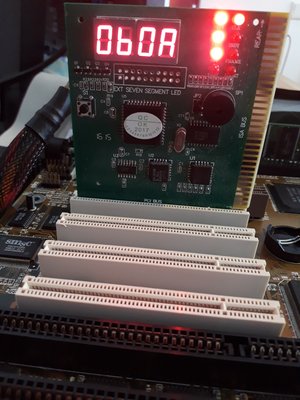

Hi folks,
in a recent effort to free up some space I decided to go through my boxes of not posting motherboards and get rid of all who are completely dead. Up first was a DFI P5BV3+ rev. C of which I remembered to be completely dead. To my surprise there is actually some activity on the post cards so I decided, since this is actually a nice board I rather see it working than scraped, to ask you guys where I could start with my troubleshooting efforts.
I know that the BIOS EEPROM is fine since I also have a working DFI P5BV3+ rev b and it posts just fine with the EEPROM from the dead rev c board. I'm testing with a known good CPU and RAM, the jumper and switches are set identical to my working rev b board (short of the AT/ATX switching jumper since it doesn’t exist anymore on the rev C board.)
The post card analyzer stops at 0b, which according to bioscentral means on an AWARD PNP BIOS: “PnP initialization; verify the RTC time, detect bad battery, read the CMOS data into the BIOS stack area, assign I/O and memory for any PCI devices ”.
This is were I'm lost, I don't know what to make of this and more importantly what component could make the system fail at this point. Any help would be greatly appreciated.

Reply 1 of 16, by tpowell.ca
In the pic, just to the right of the test card, I see that you don't have the CMOS battery installed. Install a CR2032 lithium battery and with any luck you'll be on your way.

Reply 4 of 16, by Eleanor1967
CMOS clear also didn't make a difference.
When I plug the card in an ISA slot I do not get any postcodes on the card. Interestingly the card behaves differently on every boot in the ISA slot. Sometimes I get only the 5v or 12v LED lit and nothing else, sometimes I get 3,3v, 5v 12, and IRDY. This even changes in the same slot from boot to boot.

Reply 10 of 16, by Eleanor1967
Predator99 wrote:
I think then there is an issue with the power supply? Check/exchane bad caps?
The power supply I'm using should be fine. Its a modern one (Antec EA-380D) and it works just fine with my other identical DFI board and also with power hungry CPUs like a 3.2 GHZ 478 P4 so it should be fine. Bad caps is a possibility, I already checked one a couple of month ago and it was fine, but since desoldering all of, I think, 29 caps with just an iron would take a godd while I would like to narrow it down more to specific regions of the board (e.g. near chip X).

cyclone3d wrote:
What does it get to if you install a video card? Try both AGP and PCI.
Well it doesn't post, I tested with multiple known good AGP and PCI video cards. If I keep the post card inserted when I plug the GPU in I don't get a reading on the display anymore. But the board still seems to do whatever its doing fine, since the IRDY LED still flashes once just like without a GPU.
I have some more observations. The postcard seems to work fine (just without a reading on the LED display which according to the manual is normal behavior one some boards with the card), only if I quickly power the system of and one, like when switching the post card between slots, it starts to behave weird like described above.
If this all makes any sense to anyone, pleas let me know, otherwise I'll probably bite the bullet and recap the board.
It's weird because ISA BUS connector doesn't have 3.3v rail. Do you install the POST card into an ISA connector respecting PIN1 ?
Another option is that pins of ISA connectors are heavily oxidated.
Will you get an error (C1) or beeping if the MB start without RAM ?
Is CLR-CMOS jumper set to right position ?
Of course check if there are no scratches on board
If you have a multimeter you can measure on voltage regulators of CPU, RAM and so on...

Roman555 wrote:
It's weird because ISA BUS connector doesn't have 3.3v rail. Do you install the POST card into an ISA connector respecting PIN1 […]
Yes, they card was plugged in respecting PIN1. I can’t spot any oxidation on the ISA slot, if there was any it should be rubbed of by inserting the post card approximately 500 times…
Yes the board beeps and halts at C1 without memory. CLR-CMOS jumper should be in the correct position. I do not have the manual for this rev C board, only for the B3 and a later C revision board. Assuming the this rev C board does not have this setting reversed it should be good. Physically the board looks fine, I will check the voltages, haven’t done so yet. (Probably should have done this earlier)
