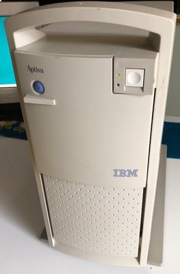

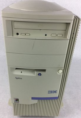

This is my favorite computer case.
They look so clean and simple with the front door closed.
IBM Aptiva 2176-C73

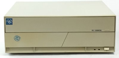

I really like the IBM PS/1 486 Essential/Value PC too.
IBM really did succeed in making there windows/dos installations simple and fail proof.
I like to use the IBM disk images in my IBM 486’s
And IBM disk image installations in my Aptiva’s.
