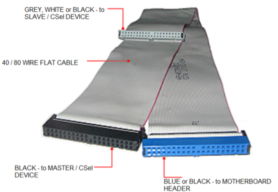

Reply 7 of 13, by PC Hoarder Patrol
Not sure I'm clear, when you say "...hooked up to either end of the IDE cable..."
Do the cables you're using look anything like this, and are you now connecting them only as marked. Can you post an image of any cables you've tried.

Reply 8 of 13, by gbeirn
If the machine refuses to post or turn on when hooked up certain ways it is absolutely a hardware or physical issue. If you are using cables like the above picture the blue end must be plugged into the motherboard.
If you are using a 80 conductor cable remove it and try plain old 40 conductor, I have seen systems do weird things with 80 conductor cables when they weren’t designed to use them. Using a BX board, ATA 33 is the max speed so no need for the 80 conductor anyway ( needed for ATA 66+).
Reply 9 of 13, by ultra_code
Sorry, PC Hoarder, that was a poor choice of words. When I meant "...hooked up to either end of the IDE cable...", I meant hooked up to either the "grey/white/black slave" terminator on the IDE or the "black master" terminator on the IDE cable, as shown in your picture. 😀
And yes, gbeirn, I assure you that I do indeed plug the right end of the IDE cable into the motherboard: I just had plugged the IDE drives into the wrong part of the IDE cable. 😀

Reply 10 of 13, by PC Hoarder Patrol
I figured as much but it's always worth checking just in case (and if I'd looked at your Flickr album first I'd have seen that for myself, Doh!).
So in summary it looks as if we may be back to the (suspect) primary IDE header, as:
- you can set up any suitable IDE cable with the sata HDD / SSD as master (using the jumper on the IDE2SAT board) and the optical as slave (using the jumper on the drive) which works on the secondary IDE header but not the primary header. This would also be true if you set both devices to Cable Select - secondary works but primary doesn't.
