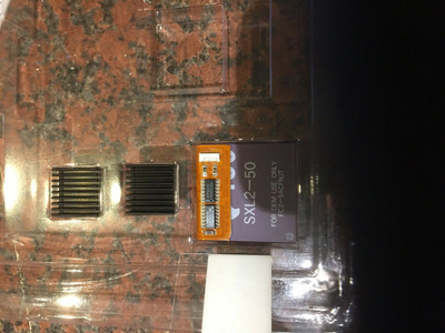

The reason I think that is that SXL requires some external logic for cache invalidation to even work in 486 socket at all, and not suffer terrible performance loss by doing a full flush on each memory refresh cycle. If Ti were serious about this chip they'd implement this themselves. But obviously it wasn't economical to redesign already existing core and create new mask sets, etc. Also apparently they didn't add anything external during the packaging process - no, they just tried to convince mobo makers to do it for them. But who would bother if a 486SX could be installed without all that trouble? And by that time wasn't all that expensive as even Intel was trying to undercut AMD's 386DX40 on price. One could say that was their first attempt to bankrupt AMD.
But anyway, some CPU upgrades came with external logic that fixes SXL, this is a photo I once found on ebay. Doing it this way however limits your choices of CPU cooling solutions.
So in the end the PGA-168 SXL is pretty much incompatible with most 486 mobos. Then why even bother making it? I see only two logical reasons, they didn't have a proper 486 core ready or they wanted to get rid of inventory glut. But for the latter it would make much more sense to add the extra logic (even externally) to make sure it works with existing mobos. But instead they've argued for extra configuration on new mobos.
