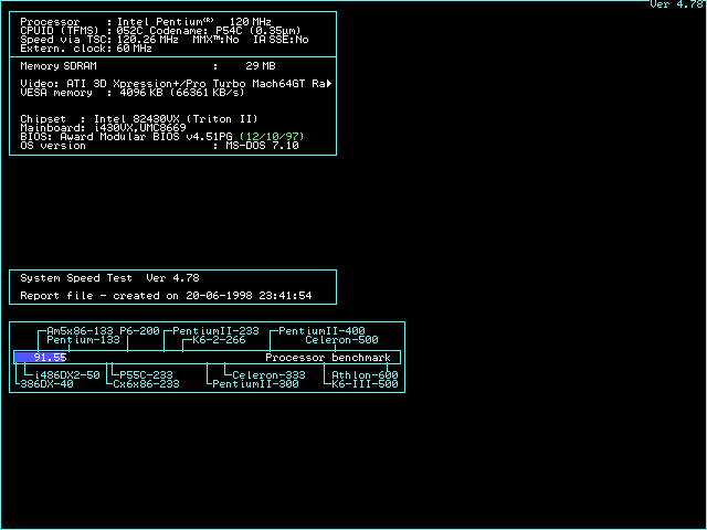

Reply 35 of 56, by Deksor
So I did run speedsys using the same mobo, the same CPU (pentium 120) and a similar video card (ATi RAGE 2 +DVD with 4MB of RAM) and here are the results :
6.82 KiB
993 views
I also tested several configs like disabling L1 cache which made the score to reach the 20's, disabling the L2 cache which had no result on the results oddly enough, using EDO ram instead of SDRAM (made no difference). I also tried to set an 1.5x multiplier which gave me "68.x". Close enough, but still ...
For the BIOS I just used the "BIOS default" settings. And I'm using the latest revision of the BIOS. (you can grab it from here : http://www.win3x.org/win3board/viewtopic.php?f=8&t=19462)
Hope it helps ...

Reply 37 of 56, by Gahhhrrrlic
Deksor wrote:
So I did run speedsys using the same mobo, the same CPU (pentium 120) and a similar video card (ATi RAGE 2 +DVD with 4MB of RAM) […]
Hope it helps ...
Well if there's any hope in hell of me fixing my computer, it's thanks to you. Against innumerable odds you not only have the same hardware to verify my issue but also a BIOS update too? Thanks a lot! I am upset my computer is a turd for no obvious reason but hopefully it's just the BIOS after all this.
Question: You have the BIOS voltage jumper settings reversed from what the manual says. Was this a typo in your post? Should I just leave the jumper alone? The voltage presumably was correct before so unless the new BIOS revision needs the voltage swapped (doubtful), I suspect I should leave it alone. Also, I believe I have 1.32 because of the big heatsink at the bottom of the board so I downloaded 55XWUQ0E. Hopefully this is the recommended one. I will try after dinner.
Just for thoroughness, I set the entire BIOS to defaults and no difference in score.
