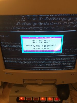

Well I got them both burned onto 27C256's and here is the result. Am I out of luck at this point or are there any other steps I could try? Also, is there a way to just modify my current bios at all through a hex editor or something to change the character set and re-burn it?

Reply 26 of 39, by quicknick
What have you used to burn the chips, your TL866 arrived already? If it did, please dump here the content of your chips. I don't have any spares now, but will get them and test my card with your BIOSes.

Reply 29 of 39, by fsmith2003
quicknick wrote:
Your SyncBios is identical to mine. What happens if you leave the original Sync on the card and only replace the MainBios?
I did try that. Same result with the frequency issue and wavy screen.

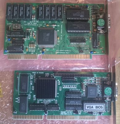

Reply 30 of 39, by Tiido
I think the problem is in the PLL chip (one in socket next to a crystal), on the photos I saw couple different ones and I imagine they're not 100% same.
Reply 31 of 39, by fsmith2003
It does appear we have different chips there yes. Would there be any way to reprogram mine to match his or are those a programmable IC?

What about the PLL Chip? Which do you have on your card and what is the one one the card you used the BIOS from?
I can also check my ET4000s if I find something matching...
My PLL chip is a Chronotel CH9201TA-NC.
I am not quite able to make out the numbers on the chip that quicknick posted on the first page showing his.
Reply 35 of 39, by Predator99
Sorry mine are very different...but maybe you can try anyway.
TSENG Machspeed KPM1600
TSENG Machspeed TEAN-94V-0 HRGVGA 9212

Reply 36 of 39, by quicknick
I'm sorry, that's really unfortunate, never expected it wouldn't work. Now at a closer look there are a few differences in the PLL area, but I feel there's a more important difference between the main video chips: yours is a TC6058AF, mine is TC6100AF (and PLL is ICS2494N).
