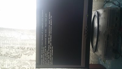

So,I've recently finished installing everything on the Pentium 3 restoration build from System Specs.
However, I am facing quite a problem I don't know how I could fix.
I am trying to edit BOOT.ini on the main drive (40GB, primary slave) running Win2k to show the 8GB drive (on which Windows 98 is installed) in the boot menu. Anytime I add the entry and set it how it should (from my point of view and using any guide over the internet), I can NOT get it to boot. I would either get a message saying "Could not boot, incorrect hardware configuration." (something along the lines, that is sure) or that ntoskrnl.exe is missing (this only happens if I select the 98 SE entry I created, the default 2k entry will boot just fine).
This is the IDE configuration if it helps:
Primary Master: Hitachi CDROM
Primary Slave: WD400BB - this is the Win2000 BOOT drive
Secondary Master: Maxtor 6E040L0 - STORAGE drive, not used for booting
Secondary Slave: WD80EB-28CGH2 - this is the Win98SE BOOT drive.
Any ideas how can I set up the boot.ini drive to boot the 98SE drive from the 2k boot menu? It must be in ARC style though (like multi(x)drive(y) etc.)
Reply 1 of 10, by derSammler
I don't think you can boot Win98 with this configuration, as you have drives that become C: before the hard disk that has Win98 on it. Try swapping Secondary Master and Secondary Slave.
Reply 2 of 10, by PcBytes
No dice.

Reply 3 of 10, by jesolo
Based on past experience, I suggest you install Windows 98SE first and then install Windows 2000.
If you want to avoid problems, I would configure your hardware as follows:
Primary Master - WD80EB-28CGH2
Primary Slave - WD400BB
Secondary Master - Hitachi CDROM
Secondary Slave - WD80EB-28CGH2
I have come across certain hard drives and CD-ROM drives that are picky as to how these are installed (master or slave, etc.) in a system but, from what it sounds to me, your setup is working fine.
Install Windows 98SE first on the Primary Master and then install Windows 2000 on the Primary Slave.
During installation of the latter, it will then create the boot.ini file on your C: drive and "point" to where your Windows 2000 system files are located.
If you format your Windows 2000 drive with NTFS, then Windows 98SE won't "see" the Windows 2000 drive and will simply not assign a drive letter for it.
Take note that drive letters will most likely be assigned differently between the two installations but, you can reassign some drives' letters from within Windows 2000.

Reply 5 of 10, by PcBytes
jesolo wrote:
Based on past experience, I suggest you install Windows 98SE first and then install Windows 2000. If you want to avoid problems, […]
Thanks, this did the trick. I ended up reinstalling 2000 Server (I need DiSKPART, which Pro doesn't have) and on the first reboot the drive showed up. I did unplug the Maxtor (connected on the same IDE cable as the CDROM) to avoid any other unwanted stuff.
