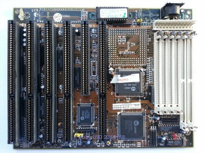

Reply 61 of 187, by Deunan
#60
Manufacturer: ??? (possibly SOYO)
Chipset: UM8498F + UM8496F
BIOS string: 12/08/94-UMC-498GP-2C4X6S21-00
BIOS label: BIOS ISA 486
BIOS version: Award Modular BIOS v4.50G
Sorry for ebay watermarked photo, I'm unable to make any better one at the moment so the seller's photo will have to do.
This seems to be a cheap mobo with minimal BIOS options. It's in a pretty sorry state and I only bought it for parts, but decided to try and fix it to see (with a POST card) if the CPU actually works.
I got it to boot though so with keyboard working I run some tests - here's quick notes before it gets disassembled:
- BIOS has HDD detection, seems to support HDDs >504MB by allowing head count to be greater than 16
- BIOS has RAM waitstate and ISA clock divider selection
- no VLB, only 16-bit ISA slots
- no external cache
- internal cache seems to cover only the first 4MBs of RAM (that's what CACHECHK reports)
- 25/33/40 MHz CPU clock options
- CPU seems to work well at 40MHz with zero-WS RAM
- mobo runs fine on a single 72-pin 16MB FPM stick
- even with just the on-chip cache, the U5 outperforms a typical 486 by about 20%
At 33MHz cache is 67.4 MB/s and RAM 30.6 MB/s (0WS), and at 40MHz it goes up to 81.0 MB/s / 36.7 MB/s
    AWARD BIOS ISA 486.zip
    43.65 KiB
    139 downloads
    438.85 KiB
    3456 views

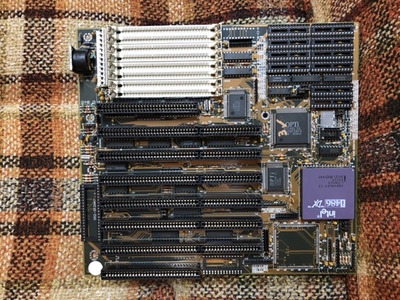

Reply 62 of 187, by Deksor
#61

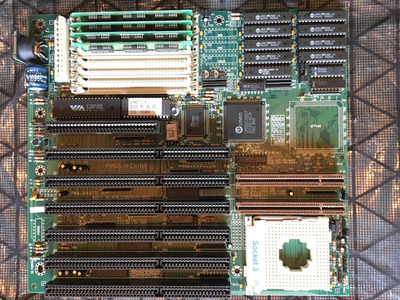

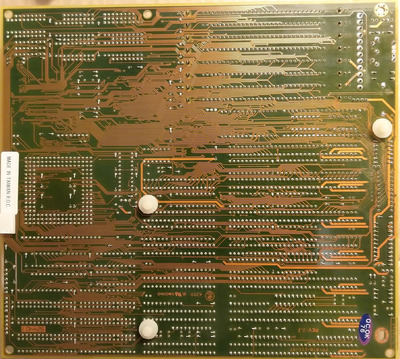

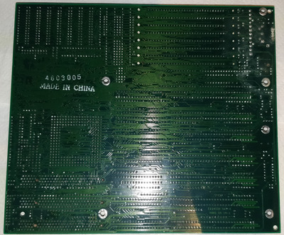

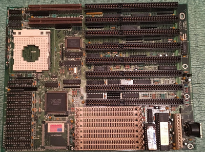

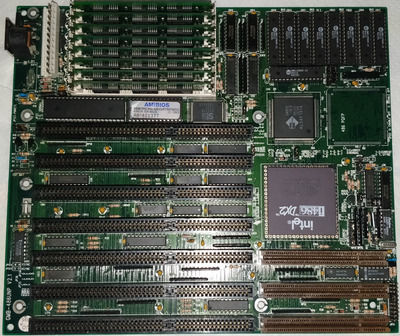

Manufacture: Gemlight GMB-486UNP v2.1
Chipset: Unichip U4800-VLX
BIOS String: 40-0405-428036-00101111-080893-U4800-VLX-H
1.36 MiB
3420 views
1.1 MiB
3420 views

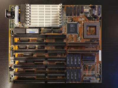

Reply 63 of 187, by Ph@nt0m-X
#62

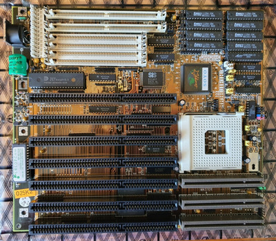

Manufacture: Soyo 025K2
Chipset: SiS 85C471
BIOS: Rev G2 - 09/26/94
1.12 MiB
3385 views
sy-25k2.zip
44.35 KiB
122 downloads

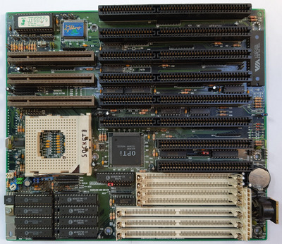

Reply 64 of 187, by BreakPoint

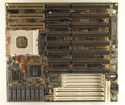

#63

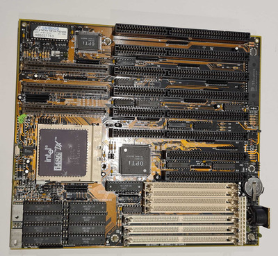

Manufacture: JETWAY J-403TG (VER.D2E)
Chipset: OPTi 82C985
    VER.D2E.zip
    42.58 KiB
    134 downloads
    1.55 MiB
    3368 views
My CPU collection - Looking for hardware in Ukraine - Ukraine vintage PC forum

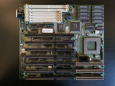

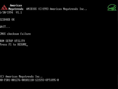

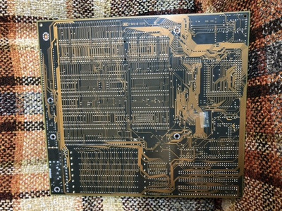

Manufacturer: JETWAY J-403TG VLB Rev D
Chipset: OPTi 82C895
POST string: 40-P301-001276-00101110-121593-OPTi895-H
Date: 6/30/1994
481.01 KiB
3277 views
51.08 KiB
3277 views
29.18 KiB
3277 views
Both Bios:
J403TGRevD.zip
108.74 KiB
150 downloads

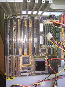

Reply 68 of 187, by AskNotes
#67

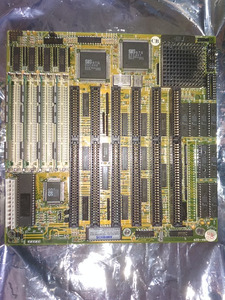

Manufacture: Chaintech 4SPI
Chipset: SiS 85C496/7
BIOS String: 02/16/95-SiS-496-497/A/B-2A4IBC31-B2
BIOS Version: Award v4.50G
    1.31 MiB
    2693 views
    1.01 MiB
    2693 views
    15.37 KiB
    3167 views
    4SPI bios backup.zip
    59.26 KiB
    112 downloads

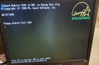

    874.41 KiB
    3188 views

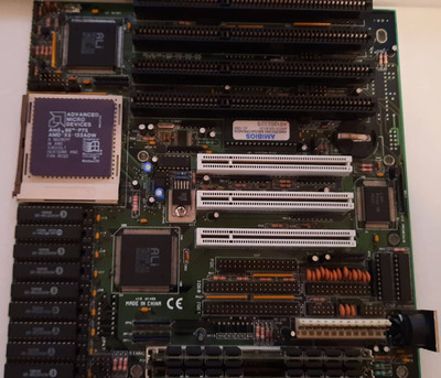

Reply 70 of 187, by Madao
#69
Motherboard: TMC PAT48AV 1.4
Chipset : ALi M1429 A1
Bios: AMI Bios, version unknown.
216.17 KiB
3108 views
PAT48AV_bios_27C512.zip
44.41 KiB
115 downloads

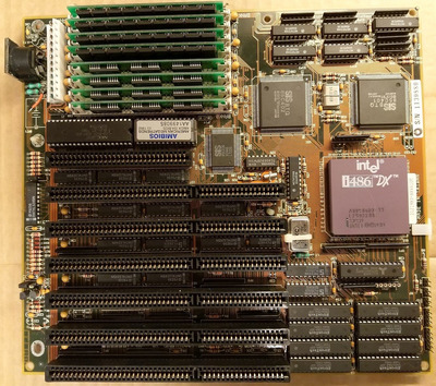

Reply 72 of 187, by fool
#72
Manufacturer: ABIT
Motherboard: AB-AX4
Chipset: SIS 401/402
BIOS: AMIBIOS 06/06/92 (different than in #71)
edit: corrected numbering
    588.11 KiB
    3028 views
    605.33 KiB
    3028 views
    486DX_060692.zip
    1.65 MiB
    102 downloads

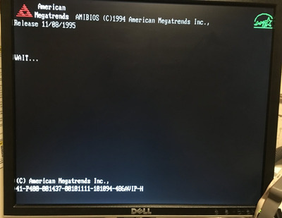

Motherboard: Amptron DX9200 AKA PcChips M915i
with Fake cache
Chipset: UMC UM8881F + UM8886BF
EPROM: AMD AM27C010
BIOS String: 41-p400-001437-00101111-101094-486AVIP-H
BIOS label: AMI 486DX ISA BIOS 1993
BIOS Version: AMI 10/10/1995: 11-08-1995
CRC 32bit Checksum: 82A4E810
Note: this Fake Cache bios is not same as the M915i BIOS 9151108s floating around.
http://www.win3x.org/uh19/motherboard/show/579
http://www.win3x.org/uh19/motherboard/show/5944
Included the 9151108s BIOS
    M915_fake_cache.zip
    239.42 KiB
    107 downloads
    886.79 KiB
    2951 views

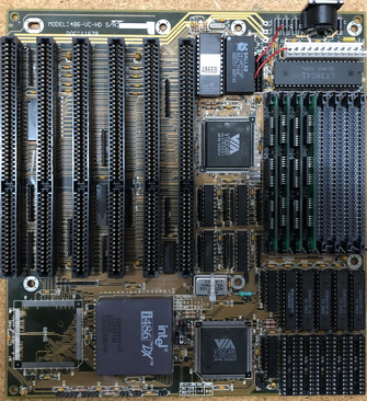

    1.28 MiB
    2915 views
    FIC 486-VC-HD DOC: 11670
    486-VC-HD_DOC11670.zip
    36.33 KiB
    106 downloads
    FIC 486-VC-HD BIOS FILE

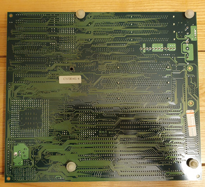

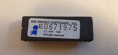

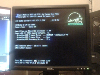

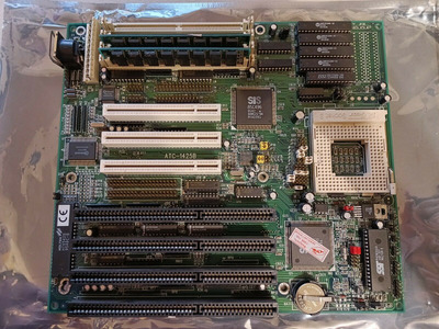

Motherboard: A-Trend ATC-1425B
BIOS Version: Award 4.51PG 04/18/96
Chipset: SiS 496/497
BIOS String: 04/18/96-SiS-496-497/A/B-2A4IBA2BC-00
489.3 KiB
2877 views
65.94 KiB
2877 views
ATC1425B.7z
95.15 KiB
98 downloads
