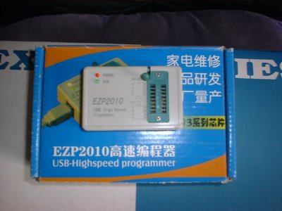

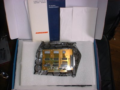

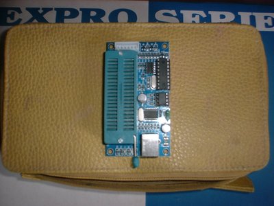

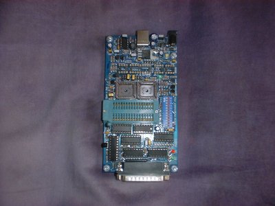

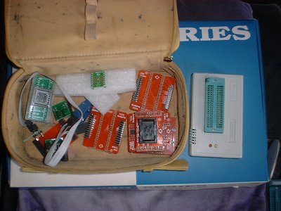

I have many programmers ..
Turns out unless you spend a fortune ..then one size does not fit all .
For most modern devices and some olde eproms ..the versatile TL866 is my go to programmer ..but I occasionally need to flash an older device ..and for discontinued chips ..The Micromaster 1000 (parallel interface) or the ISA/DOS Expro is needed.
Here are most of my proggers and adapters ..
Though this is not a complete list ..
I have some homebrew stuff ..and a couple of dedicated pic devices as well ..
rgds
VS
