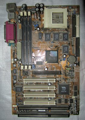

Hello all.
I just purchased what is marked as being a PCB v 2.0 (near ISA slot in corner), and have heard that some revisions of this board do not handle high current AGP cards such as the Voodoo3 3000.
The problem is that in my reading, I hear conflicting reports of having to look for a VRM that is too weak to handle the current, others mention the opposite; that is that there is no VRM on the earlier boards...
Some suggest rewiring the AGP slot to pull power directly from the ATX power connector.
So, please help clear this up.
What makes a board with rev 2.1 better at handling high current cards? Where is this voltage regulator, if any ?
Btw, the LM78 chip (in front of the AGP slot) is NOT a voltage regulator as some had pointed out in other forums, but in fact an optional hardware/temperature monitor.
Thanks

Reply 1 of 6, by tpowell.ca
Does anyone have hires pics of a v2.1 PCB to compare with?
Other than the bad AGP power, what other improvements were made going from PCB v2.0 to 2.1?

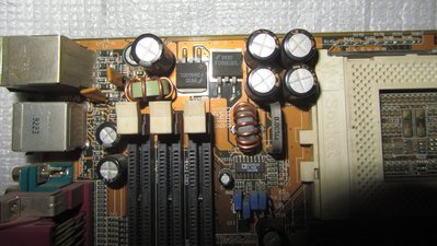

Reply 4 of 6, by BloodyCactus
well there is a couple of honking big dpaks up next to the caps in the top left corner. I'd check the chips near the two blue jumper pin blocks, one between the ram slots and northbridge above agp slot and the analog devices one at the top between cpu + ram slots.

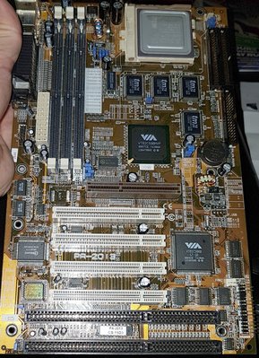

Reply 5 of 6, by The Serpent Rider
I'll post revision 2.1 photos when I'll receive mine. Meanwhile here's some revision research.

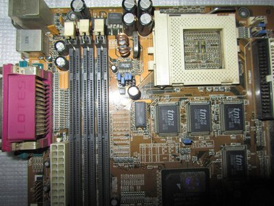

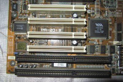

Reply 6 of 6, by The Serpent Rider
Revision 2.1
1.3 MiB
797 views
1.08 MiB
797 views
1.1 MiB
797 views
718.42 KiB
797 views
Also repost from another thread:
After some research I've decided to debunk some myths about revisions.
- Revsion 2.0 and 2.1 have practically identical VRM, so most likely both are AGP friendly.
- Revision 2.1 is the only one with additional "2.0 E-0036" PCB marking and color coded back panel (PC99 standard).
- Revision 2.0 and 2,1 may or may not have LM78 monitoring (usually don't).
- Revision 1.x have different battery and PLL placement, also additional PLL for some reason.
- Revision 1.x usually comes with LM78 monitoring.
- Revsions 1.x VRM can be easily identified by 3 large capacitors at the top left corner (both 2.0 and 2.1 have 4).
- Apparently some or all 2mb cache versions are not very good for overclocking due to worse cache quality (125mhz vs 100mhz).
