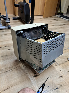

Reply 20 of 26, by Tiido
- Rank
- l33t
You may be lucky and there is a replacement available somewhere, although I have found it is near impossible to find ones for random computer monitors. Every machine has their own unique transformer in them pretty much, you cannot just take any random one although if you really are desperate and know what you are doing, it can be possible to adapt something (I have done that with a few TVs).
