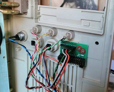

Deksor is right. The type of display you are looking for has 3 wires (in this example white/black/red)
but only 2 of them are actually connected to the motherboard. Which two wires have to be connected depends on how the turbo function is activated via the front panel button.

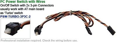

The point of a fully wired 3-wire button system is to enable easy connection in all possible scenario's - thus with motherboards that have either turbo mode on with shorted turbo header -or- turbo on with open turbo header -and- to enable synchronicity with the turbo led on the front panel whether it is connected to the motherboard or to the display. A 3-wire turbo button with all 6 wires attached can handle all possible scenario's without the need of soldering or de-soldering - you only have to ignore 1 wire to make it work.
