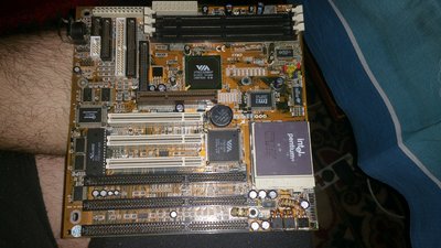

Could you provide photos of the whole mainboard and a part around CPU socket?

Roman555 wrote:
PcBytes wrote:
LE: Measured, got 0.10V on the choke.
CPU voltage depends on jumper settings for particular CPU model but 0.10V is obviously too low.
Sure. It's set to 2.8v by the way. ( although I use a ceramic Pentium, not a MMX)

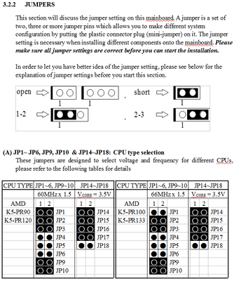

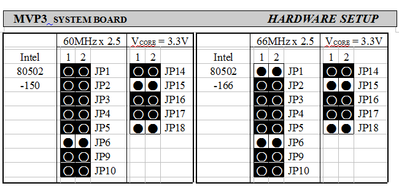

Reply 12 of 29, by Roman555
I think voltage settings (2.8v) for non-MMX Pentium are wrong.
Do you have the manual? If not it's here
Check the CPU setting for your CPUs:
    20.84 KiB
    1426 views
    52.35 KiB
    1426 views

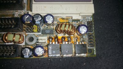

Could you clarify why so much soldering was done around MOSFETs ? Were they all replaced by working ones?
I'll try to figure out what's wrong but it involves a lot of measures. Something like this. And result is not guaranteed.
In the red circle there's something like filth. Am I wrong?
Arrows show where probes are applied to measure voltage when the mainboard is turned on. So be very careful. A black probe is always on the ground rail.
Reply 19 of 29, by PcBytes
Roman555 wrote:
It's OK. Could you clarify why so much soldering was done around MOSFETs ? Were they all replaced by working ones? I'll try to f […]
It's OK.
Soldering was done because this board had missing MOSFETs and voltage regulator (although it did POST with new MOSFETs, they were later killed by a K6-2, legit) and I replaced them again now with a new set from a known working Socket 462 KT133 board. While the voltage regulator holds up, I have had the MOSFETs blow with two K6-2s set accordingly. Anything else (like K5 PR100, non-MMX pentium chips and MMX as well) would work fine (with the exception of the MMX which I suspect it's dead as it never POST'd)
The red circle is actually a Zener diode in SOT-323 package which I replaced. Doesn't look pretty but it makes good connection.
Okay:
Diode under fan header: 0.04 Ohms on the left, infinite on the other
Linfinity chip : infinite reading on both pins
Choke between ISA slots: infinite both ways
Voltage regulator: tab gives infinite, right tab gives 4.6 Ohms, left gives infinite
MOSFET in middle: tab gives infinite, right tab gives infinite, left gives 0 Ohms reading
MOSFET in the left: tab gives infinite, right tab gives infinite and left gives infinite as well.

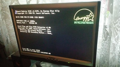

Attached below is a picture I took when I first got it to work.
