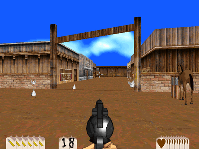

You can disable most of the smoothing features (except lightning). Are you telling me this:
365.85 KiB
1906 views

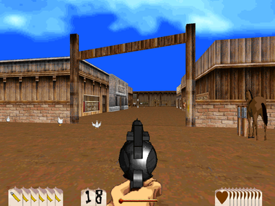

Looks better than this?:
544.24 KiB
1906 views
If it isn't obvious, the first screenshot is the software renderer at its maximum resolution 800x600 integer scaled to 1600x1200, the second screenshot is the Direct3D render at 1600x1200 native resolution.
Now two obvious things, first if you have a higher resolution monitor you can obviously get more quality out of the Direct3D render and second I would never actually play like it like that, I'm not getting into a long discussion about antialiasing and texture filtering, but I would turn them on for this game.
The Glide render has limited rendering accuracy due to its maximum resolution of 800x600 (and resolution forcing does not work).
