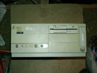

Thanks for the pointers on these boards though they're all a bit steep for my limited budget and some don't ship to my locale (wish I'd held on to the Mylex now as well as the cards, but it was sold along with its original Viglen case - pic attached, though not mine). I'll keep looking for something more local though in my price range.
