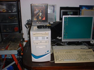

Reply 42 of 52, by Vipersan
So ..this build at least is now complete .
Now fitted with a SB live pci card ..so I guess it is time to use it.
This is the original mobo and cpu I was using in 98 and right up to just before XP surfaced.
but with Voodoo 3 agp ..which it did not have back in the day.
I'm attaching a pix of it in it's new mini tower case.
I admit it takes some getting used to the fact that the power LED is lit when the PC is off..🤣
I'd very much like to equip the build with some sort of HID ..and this doesn't have to be retro.
I have a Saitek X6-31M game pad I could use ..though only 4 buttons of the six appear to work in 98se
maybe drivers needed ?
Or ..I could use a Quickshot Joystick ..
But I have grown used to modern Top Hat type contollers Xbox stylee ..so it would be cool to have both analogue and digital on the same control pad ..
Is there one which works with 98se and connects via the SB gameport ?
USB ..being a bit limited and flakey back in the 98 days.
I'd appreciate your recommendations whatever they might be.
rgds
VS
    308.36 KiB
    533 views

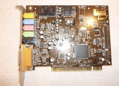

On the soundblaster Live card ..
It would appear I really should be using VXD drivers ..but I assume WDM drivers were installed ..since the only driver folder on my CD (Black with 1024 on it) is for Win 95 I think...
Perhaps someone more knowledgeable could help me here ..
Phils youtube video shows a different installation disk to the one I have ???
Bit of a minefield with the Creative Live cards ..
Both of my cards both in this unit and 'Mystery Meat ' are 5 jack socket CT4830 types ..
So can I run VXD audio drivers on these ..(This OS win98se ) ...mystery Meat (Win98se and XPpro)
can anyone advise me ?
rgds
VS
    149.07 KiB
    521 views
Reply 47 of 52, by Vipersan
canthearu wrote:
Yes, you can use VXD drivers on your SB lives in windows 98se.
Try some of the different drivers on the vogonsdrivers
Many thanks ..
I will grab a copy of Sound Blaster Live! Install (VXD 4.12.01.0905 + WDM) CD
..and go from there.
rgds
