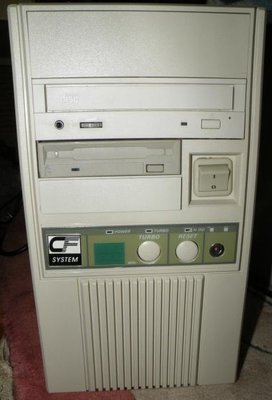

I had an Intel DX2 486 33mhz with 4mb ram and 120mb HD, VGA card, 14,4 modem, and 2x Sony CDROM, Sound blaster compatible sound card.
Running Win 3.11 FWG.
Some old laser printer that would print out 1 page every minute.
14" SVGA display.
Cheap desktop speakers.
And it cost me about $2500 which was cheap for that time.
I would say the Intel 33mhz and 50mhz where very popular back at that time.
Was good for basic office apps, games, watching cdrom videos, internet browser Netscape, and BBS bulletin boards.
but ran rather slow. I would get at least 8-16mb of ram and a good HD. and 2mb SVGA card. SB Vibra 16 is easy to find and setup.
looked like this.
