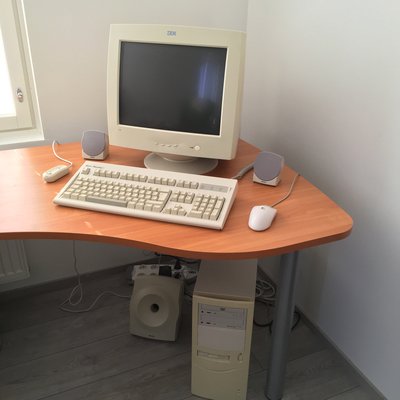

Reply 3 of 3, by leonardo
...and here's the star of the show. 1999 called. They want this thing back.
1.26 MiB
353 views
Fairly period correct. The new owner is going to be pleased for sure. 😀
