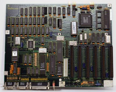

I recently acquired some XT-class parts, and since I haven't touched this kind of stuff for more than 20 years... Well, I have some questions.
There is this DTK PIM-640K motherboard, couldn't find much about it but it seems it is quite similar to other DTK models, so jumper/switch settings are not a problem. It had 640KB of RAM, but one 4164 chip was missing so I removed the whole 3rd bank until I can find a spare.
But I'm left wondering... Why so many (empty) ROM sockets? What could go in those? ROM BASIC? Is XT-IDE a possibility? Are there more "modern" BIOSes that add features that were lacking in the original XT?
The board works, started at first attempt with one of my 16-bit VGA cards that also work on 8-bit slots, but hangs with a "Disk not setting ok" error. Haven't tried to go further, because I don't have any XT keyboard and I don't know yet if any of my multi-IO cards will work on 8-bit slots (only have 16-bit cards). To solve the keyboard part I guess that I'll have to build the AT2XT keyboard converter described on Vintage Computer Forum, but if anyone has other ideas... please shout.

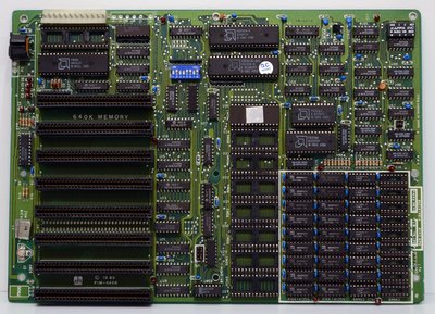

The second board is a Samsung Electronics XT board, also with 640KB RAM - it has onboard serial, parallel ports, floppy controller, real-time clock and video (Paradise PVC4, CGA-compatible from what I've read), all of which can be individually enabled/disabled with jumpers. Things are quite straightforward with this one: also POSTed at first attempt, but after a few test it halts with a "Keyboard Error, press F1 to continue". 😁 I had to use the same VGA card because I don't have any CGA monitor around (and cannot get one because of space)... And this brings another question - what can I use to convert CGA/EGA to VGA? Ebay seems flooded with converters, do I choose one at random or does anyone use a specific model and can recommend it to me?
Regarding both boards, do you think they will support 1.44MB floppies?

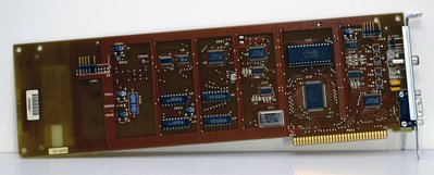

Last, there is this 8-bit video card. Couldn't find much info about it. The main chip is Compaq branded, 104495-001. The ROM is an OKI M3864, which has some peculiarities (two Chip Select lines) so my TL866 can't read it. There are four 4416 RAM chips. There is a D-Sub 9 pin connector, a RCA one (composite?) and a 3-pin header (light pen?). Couldn't test it, as I said there's no monitor, and I'm yet to source a cable to connect what I suspect is Composite out to my TV.
The text on board:
ASSEMBLY NO. 000525
DIAGRAM NO. 000526
VDU CONTROLLER, GA3
BOARD NO. 00527-001
The text on board:
ASSEMBLY NO. 000525
DIAGRAM NO. 000526
VDU CONTROLLER, GA3
BOARD NO. 00527-001
Given that CGA doesn't need/have its own BIOS (those functions handled by motherboard BIOS), this is almost certainly an EGA card - quite a late one too given the level of integration - despite beging a 3/4-length board, it's almost empty with that Compaq-branded controller doing the heavy lifting. The RCA is indeed composite, for backward compatibility with CGA/MDA. Only question is whether it does PAL or NTSC.
The whole thing looks strikingly similar to my ATi Small Wonder - although that does squeeze everything onto a 1/4-length board.
Reply 2 of 6, by quicknick
Good point about the BIOS. But the Samsung XT board also has a 27C64 ROM near the Paradise PVC4 chip, would that mean it is an EGA (and not CGA as found on the net)?
If the composite is NTSC won't I get anything on screen, or will it be black&white only?
Yes, yes and yes.
The cheap gonbes converters on ebay won't work directly since they are intended for arcade machines. I recommend the "MCE2VGA" project.
The DTK won't but the Samsung might. You can add HD floppy support by using a 16-bit multi I/O card and either adding an HD floppy BIOS or booting DR-DOS.
Reply 4 of 6, by bakemono
Doesn't seem like much RAM for an EGA. But the oscillator might be the big clue, is 18.9MHz common on EGA cards? I think mono cards used 16.2MHz.
Reply 5 of 6, by quicknick
@Plasma Thanks! Your project is gold! I had just a quick read, so I might be wrong, but with all those extensions the DTK board should be able to cover everything (BASIC, boot from hdd, HD floppy), I just have to order enough 2764 EPROMs, thus surpassing the Samsung board which uses a 27128 EPROM and I guess isn't really moddable.
@bakemono After the quickest search, most EGA cards seem to use a 16.257MHz crystal...
Reply 6 of 6, by Plasma
Yes, but you will need an XT-IDE card to use a modern HDD (the IDE on a 16-bit multi I/O won't work). You can also use an 8-bit SCSI card with a boot ROM like the TMC-850. Or go old school with an MFM controller.
