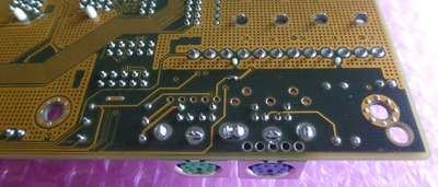

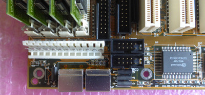

This thread shows how to upgrade a PS/ 2 mouse: Adding PS/2 mouse components to a Chaintech 486SPM
I downloaded feipoa's worksheet and I still have some questions:
What is the value of R147? He brings the IRQ12 to AMIKEY-2 (KBC) pin 36. This is missing on my board (2.1).
This parts list is complete?
L4, L5 - 2 x 1uH (Bead coil)
2 x 47p (Designator not readable)
R147?
PS/2 mouse jack
I've already soldered it in so far...
