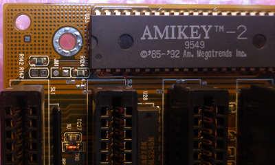

yes - both boards have a different layout., but your worksheet refers to the MS-4144 (top left corner) or did I misunderstand that?.
The photo shows the position of R147 on MS-4144 Ver. 2.1.
Unfortunately after intensive research I have not found anyone who has already modified this.
Regards
Aerion

Oh, I don't even remember submitting my pencil-to-paper worksheet on the MS-4144 ps/2 mouse mod. R147 is a convenient location to connect IRQ12 to the KBC pin 36. You will want to short the R147 pads together with a wire, or use a 0-ohm resistor. I wanted to be more involved on my board, so I soldered in a jumper header at R147. Aside from the R147 short, it looks like you just need two capacitors, and two inductors. I don't recall if any modifications are needed under the KBC socket. I don't think so, but would have to see a photo of your board with the KBC removed to determine that.
Reply 23 of 50, by Aerion
I measured the connections (MS-4144_PS_2.txt).
As suggested I will use R147 as solder jumper.
If it doesn't work then I will unsolder the AMIKEY-2 and post a photo.

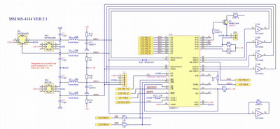

The schematic is so far done.
500.15 KiB
387 views
Thanks again!

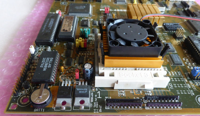

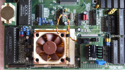

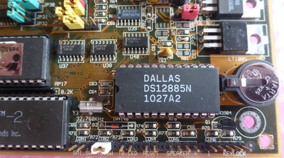

I have some small 19" (2U) cases that I use for this and other projects. These boards are also modified:
- ASUS PCI/I-486SP3G with PS/2 and modified RTC (DS12887A replacement)
1.69 MiB
680 views
1.55 MiB
582 views

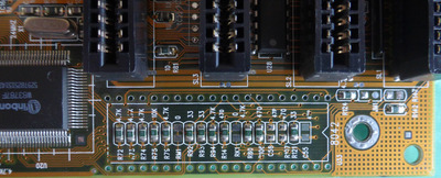

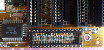

- ELITEGROUP UM8810P-AIO with PS/2, self designed and built VR module and RTC (VR-102 & DS12887A replacement)
1.74 MiB
680 views
1.21 MiB
576 views
All boards work perfectly and stable. The MS-4144 is now the last of them...

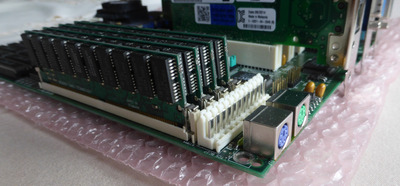

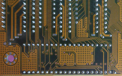

AMIKEY-2 is soldered out, now I can update the schematic...
1.65 MiB
536 views

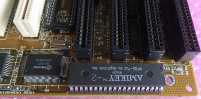

Finally the PRECI-DIP socket is soldered and the AMIKEY-2 has a new place:
1.68 MiB
507 views
1.24 MiB
507 views
1.45 MiB
507 views

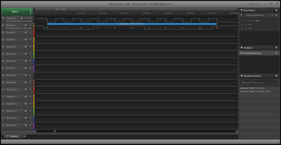

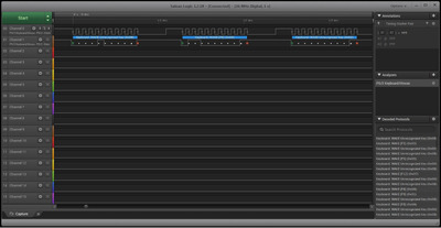

R147 is now a 0R resistor, not jumper. Unfortunately the mouse didn't work - no clock and data on KBC. Looks like mouse disabled, but mouse is enabled in BIOS. Tried other KBC, the same result. Any suggestions are welcome...
Measured keyboard timing below:
156.4 KiB
498 views
Niemand ist nutzlos, er kann immer noch als schlechtes Beispiel dienen...

No mouse timing still on the KBC, but when I press a button, a low pulse is generated on the PIN39. I think the KBC was not initialized correctly.
Extract from the VT82C42 data sheet:
TEST0(1) is expected to connect to KBCLK no matter what mode the VT82C42 is in. TEST1(39) is expected to connect to KBDATA when in AT-mode, and is expected to connect to MSCLK when in PS/2 mode.
152.87 KiB
422 views
Is jumper JM1 on your board open or closed?

Good news - PS/2 mice works with your modified AWARD BIOS! I have testet AMIKEY-2 and VT82C42N. The AMI BIOS AF54S seems to have a bug... The last schematic update above in my thread.
Now I'm done and glad...
