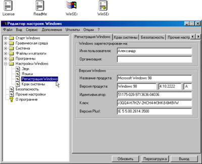

WinSEr can change s/n of installed copies of Windows 9x. But it is available only in Russian language, so I'm attached a screenshot with all need:
Ключ field is the volume serial number (installation key), Идентификатор (ID) is the calculated key (that is showing in the System Properties dialog window under the user's name). To get the fields visible you need to open Настройки Windows>Регистрация Windows tab.
I don't know how the ID calculates, but you may install system with the need serial to any machine and copy the ID from it.

Another way to change Installation Volume ID is to edit it directly in the registry:
1. Open RegEdit.
2. Open HKLM\SOFTWARE\Microsoft\Windows\CurrentVersion
3. The Volume ID (s/n) will be in the ProductId key. It is a raw serial number that enters at installation time.
To change Volume ID of a hard disk partition (FAT/FAT32), that's visible after DOS DIR command, use any hex editor that can work with raw disk data. In WinHex you need to select the partition, Alt+F12-Boot Sector FAT, then find by eyes the Volume Serial Number and edit it. Finally, don't forget to save changes and reboot the PC.
