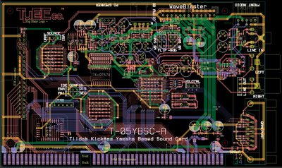

There's no formal order page or anything, everything has been via e-mail and PMs. I can tell now that cost is going to be 95€ + shipping.
Eventually I'll look more into web side of things and attempt to make an order page (I very much hate web stuff 🤣).
New board has analog side routed, only digital side is left. I started over and I got a cleaner result with much more playroom for everything :
227.7 KiB
2664 views
Main differences between previous board and this one are that there's RCA outputs, 4 layer board and a larger CPLD with what I can hopefully fix the 486 problem I have experienced. It'll sit as a middleman between ISA and YMF and passes only the right stuff. Hopefully that'll cure all my problems.

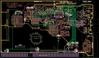

Board routing is more or less completed now, time to make it all pretty and add in copper fills.
283.57 KiB
2626 views
Some feature creep happened and IDE connector is a bit more useful now (it can be either primary or secondary) and there's a boot ROM socket for something like XTIDE (I will not be populating it and configuration is all soldering based aswell, it isn't going to be a feature that gets much use). I have also reduced PCB under the gameport, I have one board that has socketed keyboard controller and the edge gets in the way on it (plus the brackets came out about 1mm lower than they should so it is a win-win).

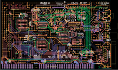

Board routing and checking is all completely done, aaaand I cannot get anything until Feb 12 due to the Chinese new year. At least I have time to work on the CPLD and make any changes to its pinout in case of some compilation inefficiency due to proximity issues of relevant signals.
Reply 171 of 340, by Tiido
I have discovered that the YMF721 chips my friend got me are duds, they have different chips inside them (and no clue what they actually are). I've notified my friend and we'll figure out how to proceed.
I also discovered that fundamental mode 33.8688MHz crystals still need 3.9Kohm bias resistor on the oscillator rather than 1Mohm with YMF71x.
This is how the board is like (without copper fills enabled) :
