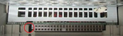

I cannot find the right hard drive fit for the Toshiba Satellite 225CDS laptop, as the item I purchased has no hard drive.
Reply 3 of 23, by PC Hoarder Patrol
And is just what you'd expect to see.
It's a nominal 44-pins...43 actual pins / holes plus one missing / blank orientation pin / hole (bottom row, just left of centre) - a standard drive will fit fine.
Reply 4 of 23, by Muz
This type of hard drive is not 44-pin, correct? As it has 4 extra pins in its bottom left.

Reply 11 of 23, by PC Hoarder Patrol
As has been mentioned above, you don't need to worry about these (non-removable) 'extra' 4 pins - they are only there to allow for correct Master / Slave / Cable Select configuration.
If you look at the image you posted earlier of the laptop drive interface...
78.88 KiB
988 views
...the 4 pins will sit out of the way, somewhere inside the red circle - they aren't designed to be connected, just jumpered if required.

Reply 16 of 23, by PC Hoarder Patrol
Muz wrote:
Do you have Toshiba Satellite laptop as well?
No I don't, but the 44-pin IDE interface is a widely recognised standard across numerous platforms.
Not sure why that drive you bought isn't recognised as physically it looks OK, so maybe it's a bios limitation. According to this spec sheet (the 220CDS & 225CDS are basically the same thing)
https://usermanual.com/document/7986/toshiba- … cification.html
it ships with a drive of approximately the size of the MK1403MAV, like this one
https://www.ebay.co.uk/itm/TOSHIBA-MK1403MAV- … .m4383.l4275.c4
As for the one you bought being a tight fit, a few things are worth noting. These drives tend to be snug fits when installed in laptops (you want to minimise movement between the drive and the interface / drive cage) but in your case maybe the one you bought is too thick to fit (sometimes referred to as the Z-height) and really isn't designed for your laptop. The other thing I noticed was what looks like a piece of sticky label caught on the drive cage (upper right corner of your picture) and which looks somewhat similar to the number label (31515077) in the picture the seller posted. Maybe this happened when you inserted / removed the drive, so try removing it just in case it was stopping the drive fully seating on the connector.
Reply 18 of 23, by PC Hoarder Patrol
You'd normally get it from the manufacturers website or thru a product spec sheet but for such old drives these can be hard to track down so, based on the Ebay pics, I'll take an educated guess!
The first one you bought looks as if it could have a Z-height of either 17 or 19mm. The one I linked, which you've now ordered, looks more like either 12.5 or 15mm. Most modern-day drives are either 7 or 9.5mm. Generally speaking, the higher the drive capacity / physical drive platter count, the greater the Z-height. Check this link for details
http://www.pcguide.com/ref/hdd/op/formIn25-c.html
