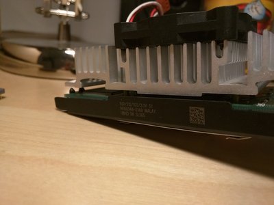

Asus P3B-F rev 1.04 Intel 440BX
Intel Pentium III 1000EB SL4BS

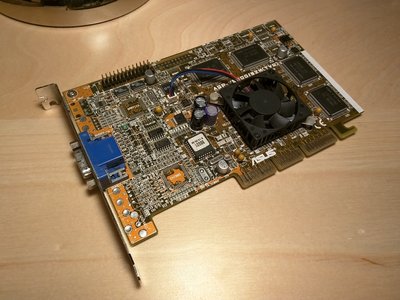

Asus AGP-V7700 TVR 32M AGP NVIDIA GeForce2 GTS

the first version of my first retro computer. the chieftec case was nos, and i have bought a new beige mouse and keyboard.
Asus P3B-F rev 1.04 Intel 440BX Slot 1
Intel Pentium III 1000EB SL4BS Slot 1
SECC2 cooler
Samsung PC133 SDRAM 7.5ns 256M

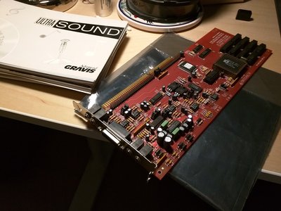

i have tried some sound card alternatives.
Creative Sound Blaster AWE64 Gold PnP CT4390 rev 01 ISA DSP4.16, CQM => very disappointing dos performance, it is not really better than any non opl3 awe32, horrible fm

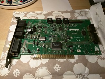

Diamond Monster Sound MX300 PCI Aureal Vortex2 => the live is more supported, and easier to pair with an isa sound blaster
Gravis Ultrasound 3.74 1M ISA => isa timing problems

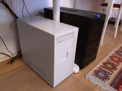

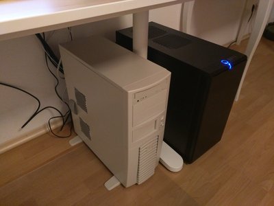

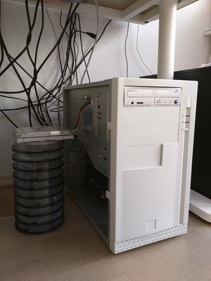

finally i found a nos and authentic computer case: In Win IW-A500
    1019.66 KiB
    4364 views
    410.51 KiB
    4364 views

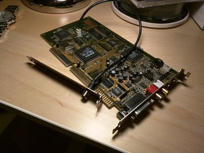

nos cdrom - it is not authentic, but not grey 😀
LG GCR-8523B 52x CD-ROM IDE

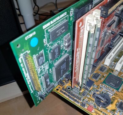

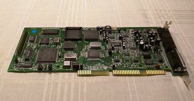

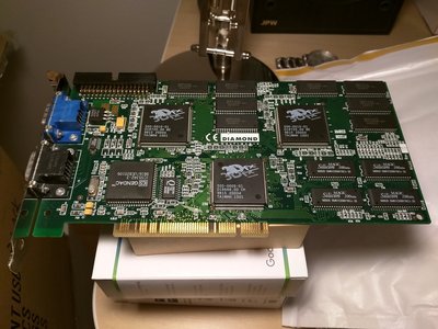

compatibility improved:
Diamond Monster 3D II 12M PCI 3Dfx Voodoo2 => glide support for 97-98 games
Creative Sound Blaster AWE32 CT3910 rev 01 ISA DSP4.13, CT1747 OPL3 => real opl3 support for older dos games

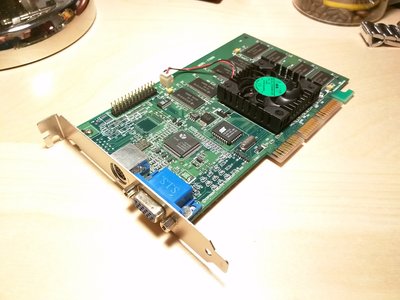

new goal: build a 1999 computer.
Intel Pentium III 500 SL365 Slot 1
Creative 3D Blaster CT6810 32M AGP NVIDIA RIVA TNT2 Ultra
i really like it, but it can be too slow at 2000 games. i need a better compromise.

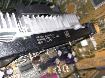

Intel Pentium III 700 SL3XM
Toshiba PC100 SDRAM 8ns 64M x2
Asus V6600 Pure 32M AGP NVIDIA GeForce 256
finally i found a gf256 as a "better compromise" - i did a lot benchmarks, and checked many games:

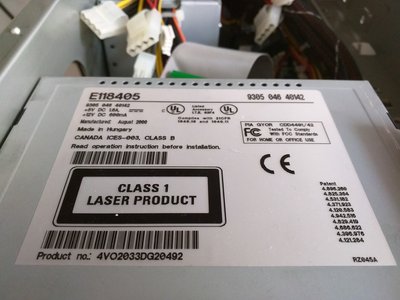

HP E118405 4x4x32x CD-RW IDE
philips inside, they sold it as iomega, hp, etc in 1999.

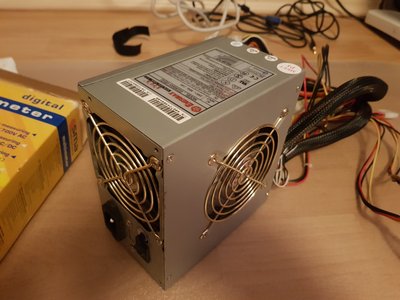

Enermax EG365AX-VE(G)
it is from 2002, not authentic, but very good quality psu with native -5v.

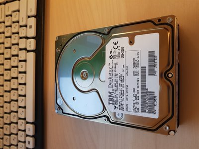

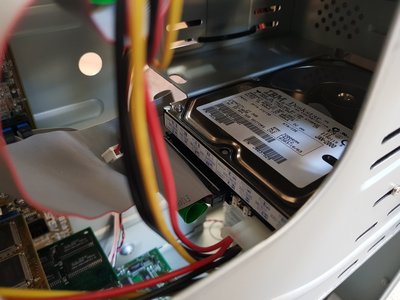

IBM Deskstar 34GXP DPTA-372730 27G IDE
the second biggest model from the 34gxp series (the 34gb version is over the limit, and it has problem with the authentic bios). early 7200rpm drive, it is noisy 😀

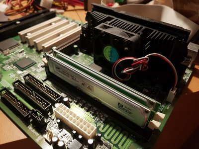

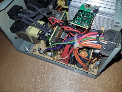

FSP 235-60GT
this psu would have been the last element of the puzzle, but the capacitors are bad. i plan to recap it.

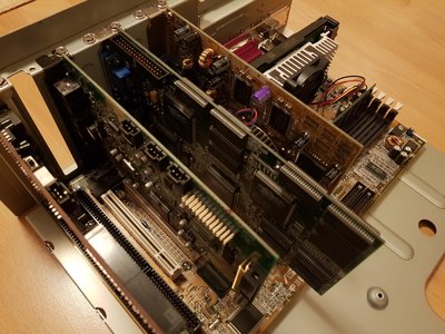

FIC KC19+ Intel 820 Slot 1
Samsung PC800 RDRAM 128M 2x
yeah, it is not bx, and not from 1999, but it has two isa slots! i had to try it - unfortunately the dma handling of the isa slots is very ad hoc. go back to the good old bx.

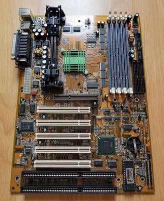

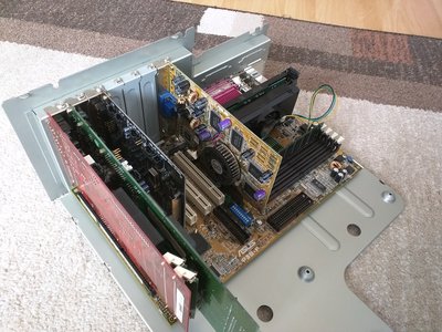

Abit BX6 v2.02 Intel 440BX Slot 1
an alternative mainboard - it has better layout than the p3b-f:
* the mainboard pins are not (so much) overlapped by the isa cards
* the floppy connector is in a better place
on the downside:
* slightly slower with the default bios
* it does not detect the ide-sd adaptor
actually i keep the p3b, and the bx6 will be the backup board.

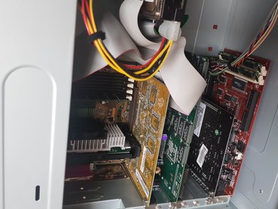

    1.35 MiB
    4350 views
    1.46 MiB
    4350 views
Overdoze of the demoscene

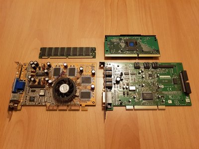

Reply 14 of 29, by arncht
date changed: 2000.03
i try to looking for a gf256ddr. but temporary there is the gf2gts
awe32 removed (there is the mmx for the late dos games)
live replaced with mx300.

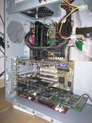

Mosel Vitelic PC133 SDRAM 7ns 256M

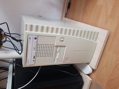

updates:
Mitsumi FDD
Yeong Yang case
