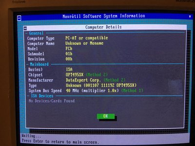

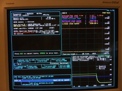

Reply 23 of 72, by aquishix
kixs wrote:
Find a proper manual or jumper settings for your board. […]
Then check jumpers for:
- system bus speed (unless you have an oscillator - what is its speed?)
- turbo jumper!!
Only these two settings have mayor impact on the system performance. BIOS settings can have around 10-15%.
Post the photo of your board and results from Speedsys, NSSI.

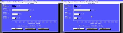

It's definitely not the turbo button; I wasn't born yesterday. 😉 When the turbo button is pushed, the system crawls to about the speed of an XT Turbo or maybe a low-end 286. Otherwise it performs like a low-end 386.
I'm pretty sure it's not the bus speed either, but not quite as confident about that. The oscillator is rated at ~14.3MHz, as you can see in one of the photos I'm going to attach to this message.
As you requested, I ran the two benchmarks you mention.

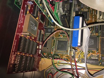

I couldn't get a good picture showing this, but part of the silkscreening reads: "VER-1.2 495SX"
I can't find the exact manual/jumper settings for this motherboard, but the two closest I've been able to find are:
https://stason.org/TULARC/pc/motherboards/I/I … OPTI-495SX.html
https://stason.org/TULARC/pc/motherboards/D/D … OPTI-495SX.html
NSSI reports that it's a Dataexpert motherboard, which is plausible, but the closest Dataexpert motherboard listed on stason.org has JP15 and JP16 in between the ISA slots instead of JP51 and JP52...
Here are my jumper settings:

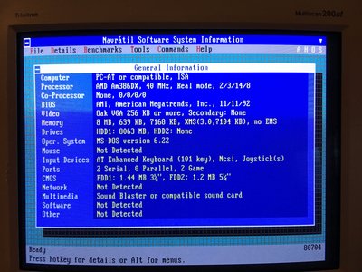

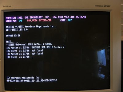

Reply 24 of 72, by aquishix

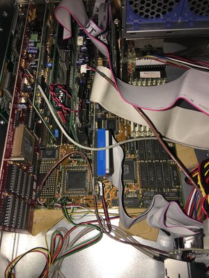

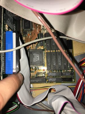

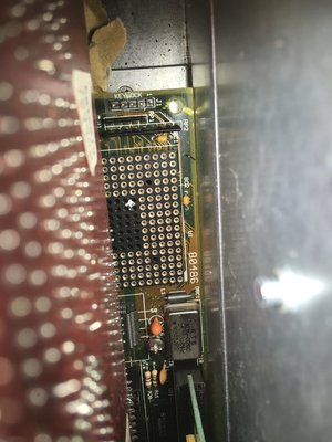

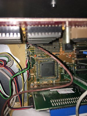

Here's the next batch of photos. I pushed the turbo button on one of these to show you what I mean about how the performance drops off a cliff. 😉

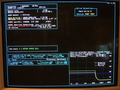

Reply 25 of 72, by aquishix
kixs wrote:
Post the photo (...)
And here's the last batch.
(Sorry for the image spamming, guys!)
Reply 26 of 72, by kixs
You said performance of your board is like 386SX-25. By the benchmark results it looks more like DX-33 or even better. Speedsys result of 8.11 is in range of 386DX-40.
This is your board:
My guess there could be some setting in the BIOS that drops the performance. Play around with it or post screenshots of all BIOS settings.
PS:

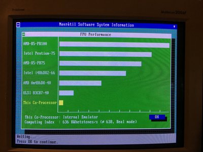

Reply 32 of 72, by aquishix
kixs wrote:
You said performance of your board is like 386SX-25. By the benchmark results it looks more like DX-33 or even better. Speedsys […]
This is your board:
PS:
Turbo button is the most common mistake when performance difference is too big - like 386sx levels.

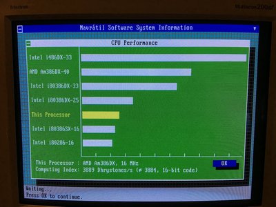

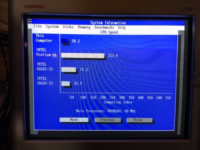

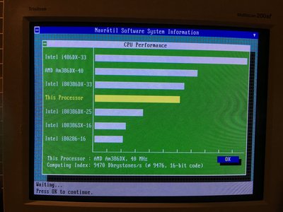

Here is the benchmark that I was using prior to your suggestions. (Attached.)
I think you would agree that based on THIS benchmark, my math wasn't far off: If a 386DX-33 measures 35.9, then 30.2/35.9 ~= .84123, and .84123 * 33 ~= 27.76. I've also seen it come in at 30.0 plenty of times, which would result in a MHz equivalent estimate of 27.58 -- which is only 10.32% more than 25. So I was within ~10% based on the benchmark I had been using prior to your suggestion to use NSSI. This is one of the benchmark programs that comes with Phil's Computer Label DOS benchmark pack, but I can't remember the specific benchmark name at the moment.
I'm beginning to suspect the that the FPU is actually the problem, based on the FPU Performance screen in NSSI. If these benchmarks are using integer math but the FPU is hung up for some reason(mysterious jumper settings?), that would explain it. I can re-compile my Mandelbrot benchmark and target the i386 architecture this afternoon, and then run it on my 486DX2-66 system and my XT Turbo 10MHz system for comparison. Both of those systems are performing exactly as they should, so that should help box in the numbers and convince me that I'm measuring what I should be measuring. It uses so few variables that it never hits main RAM; everything is allocated on the stack and fits in less than 64 bytes, IIRC. I could write an ASM program that would fit in the registers entirely and not even bring cache into the picture, just to be sure.
Fun times.

Reply 33 of 72, by konc
My DX/40 with the optimum vs the default safe settings and a crapton of wait states. Does the number achieved using the the safe settings look familiar?
105.92 KiB
817 views

Reply 35 of 72, by konc
Lowest possible of course, WS set to 0 and timing to the tightest. But I thought you "changed them carefully one at a time, and only after reading up on them to fully understand what they mean" and that "I'm barking at the wrong tree" so it can't possibly be that 🤣
(lower everything, memtest and run stuff, don't just assume your ram/cache can handle them just because it boots. Oh, and leave that poor CLK setting to /5 -unless you intentionally overclock the bus)
