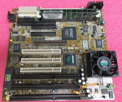

Hello, I am asking for advice about some Super Socket 7 builds.
I have 4 of these Super Socket 7 motherboards so I can do various builds. They are like NEW. I think they are system pulls from computers that were never used.
They are in ESD antistatic bags and don't have any signs of use on them.
Purpose: To be able to play as many old games as possible, DOS time machine.
I would like them to perform optimal. I don't want to over load the computer CPU.
I was inspired by Phils build.
https://youtu.be/9CgisEFObjA?t=1294
But I don't want to use a Roland MT32 & MPU-401 Midi interface as I don’t have one.
Just the sound card. Do I need one ?
Components I have.
They are the Baby AT, Super 7 motherboards. They have USB, PS2, AGP, etc.
Soyo SY-5EHM v1.1
VIA Apollo MVP3 & VIA Apollo VP3 chipset
IDE controllers.
Award Bios
AGP, PCI, ISA slots
Up to 256mb. ram
Y2K compliant
PC98
2.0v - 3.5v CPU
Up to 500mhz CPU.
Currently, they came with a Pentium 233mhz CPU and 256mb ram.

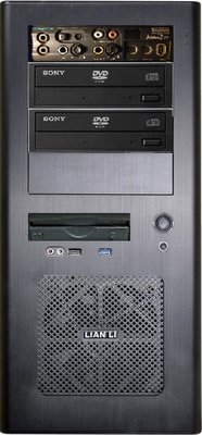

Case
LIAN LI PC-8NB
Antec VSK4000E

    LIAN LI PC-8NB

    Soyo SY-5EHM v1.1
Reply 2 of 6, by Intel486dx33
I just opened up all the sealed ESD antistatic bags and inspected all the motherboards. They look NEW with no dust or markings or signs of use.
Only one motherboard has bulging caps. It's an easy fix. Not a problem.

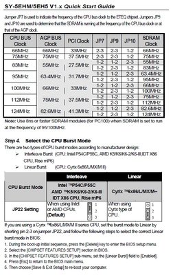

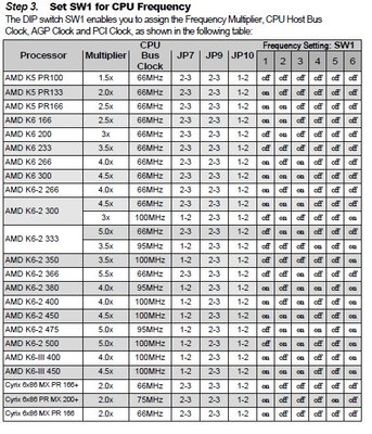

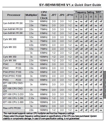

Reply 4 of 6, by gdjacobs
1) Is there a jumper header or BIOS option for setting FSB and multi on any/all of these boards?
2) Do any of these boards support 50mhz FSB?
3) I take it your P233 is a P55C MMX chip?
If the answer to these questions is yes, I'd look at making a Ludicrous Speed Pentium MMX time machine that can be clocked down to around ~100mhz and up to 300mhz with 100mhz FSB. With cache and branch prediction disabling, you'd be able to achieve slow 386DX performance with lots of performance options all the way up to Pentium country.
    150.03 KiB
    472 views
    152.07 KiB
    472 views
    168.89 KiB
    472 views

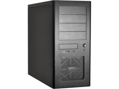

So I think I am going to go with
K6-2 3+ CPU @ 500mhz.
256mb ram PC-133
Voodoo-3-3000 AGP with modified larger fan.
Conventinal IDE 72000 rpm hard-drive ( Seagate )
Sound Blaster Live 5.1 PCI with live drive
Slot loading Sony CDROM
IDE DVD Sony
250mb ZIP drive
10/100 Network adapter.
Floppy drive
IDE controller. ( Promise, iWill, or High point )
PS/2 keyboard with laser mouse.
Lian Li case
