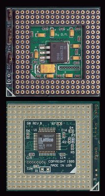

Evergreen charged an extra $20-$30 for the cacheback feature. The upgrades that didn't support cacheback didn't come with the lattice IC, so obviously it contains some magic.

I know this through a combination of posts on usenet, and these photos. No CB jumper, no lattice IC.

Oh nice find.
Do you have any idea what the BLK/RED holes are for?
And what about this CB jumper? I assume CB is for write-back cache. Move the jumper up two pins, it is for write-through cache. What about no jumper, or jumper on the middle?
Lastly, there is this OD jumper, which I assume is intended for an overdrive socket. There are 3 possible positions: 1-2, 2-3, no jumper. Any idea what this jumper does? I wonder if one such position is to bypass the onboard VRM?
Have you seen a manual for this interposer? I could only find the manual for the Evergreen manual with the QFP Am5x86 soldered on.
Reply 11 of 15, by luckybob
So you would need to find one of these lattice chips, pray to the electronics gods that it can be poked hard enough to reveal its workings, or just use enough knowledge to do it yourself from scratch.
My limited experience with these things in macintosh products tells me the lattice chip is just watching the data bus for a certain combination of 1's & 0's and intercepting certain register commands to replace them with something else. The lattice chip is just a basic CPLD by the looks of it.
it might be as simple as the program sending a special set of data through the processor that the cpld will trigger, and send the corrected data to the cpu that causes the missing functionality to work. I'd wager getting the chip would be fall down easy, but finding the program and programmer would prove to be challenging.
I'd wager the black/red are for the black & red leads of a small 5v fan.

I would guess that the cache jumper lets you set WT, WB and CB. I will let you know when I take possession of my Evergreen kit. I'll scan the manual and upload it to VOGONS.

Only if protection bit isn't set, which it normally is. If there's no storage in the chip you can brute force the logic out of it by inputting all possible combinations and observing the output.
Reply 15 of 15, by feipoa
So if the "protection bit" isn't set, you can read these logic controllers like an EEPROM, that is, copy it and write it to another logic controller?
